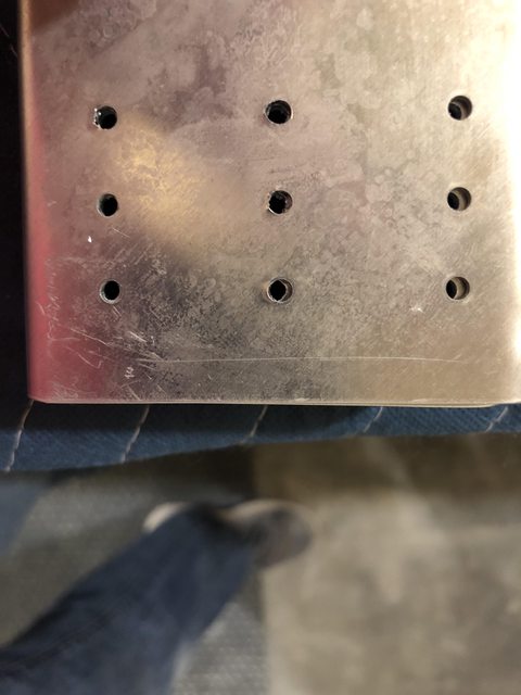

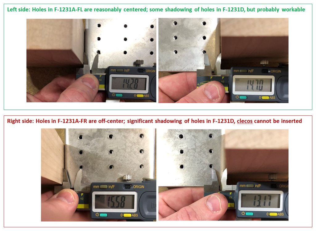

I got the rollover structure all clecoed together and slid onto the bases(attached to fuse) without any issue, but when I went to cleco the structure to the bases, I found one side was so bad that the clecos could not be "persuaded" into more than one hole, all others were too badly shadowed. I brought all the parts back to the bench for measuring and found that the base-attach holes in the right side roll bar were significantly off-center.
Obviously I'll send a note to Van's, but has anyone else run into this?
I just spent all day yesterday dealing with what appears to be the same issue. I took everything apart and verified the F1231D hole pattern is the same as F1231A. Pattern was the same, but F1231D was not centered in F1231A. I ended up filing F1231D locally to make just enough room for F1231C to fit between the parts with a small amount of bending outward of the 1231A flange. Not sure if everyone has this issue, or Vans has a batch of poorly aligned parts.

The pictures were taken on the bench with the structure disassembled - the best possible chance for alignment. There is simply no adjustment in the fit-up, the base is press-fit into the roll bar.
As an engineer, I spent my first five years in a stamping plant, some of it as a supervisor in the tool and die shop and some in quality control, among other areas. This F-1231A-FR isn't even remotely acceptable in my opinion. Even the -FL part never would have left our shop, but it's at least close enough that some light filing and tweaking will get it usable.
It looks to me that the holes were punched before the forming operation, which is less than ideal and unnecessary for these particular holes. If that's not the case, then the fixturing for the punching operation is extremely poor or has failed in some way.
Maybe these holes should be left to the builder to match-drill using the CNC'd base?

Got the final answer from Van's - my F-1231A-FR is out of spec and they will be sending another.
