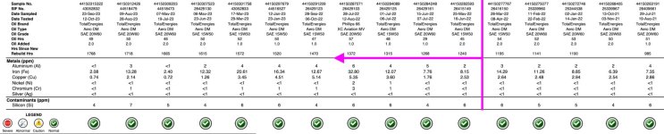

I'll add some tangible data to the debate...
My engine was fitted with a S15 filter on 27-March-2022, at a TSO 1195:32.
Oil change is performed every 50h, analysis performed courtesy of AOA.
Latest probe was sent off today with a TSO of 1818:15, results open...
Attached the evolution, magenta line is dateline of installation, the arrow pointing towards the present (and future :)).
Interesting Dan, as the highest metal PPM values are when you used (once) Phillips oil...
That instant seems to show more difference than before and after the S15
Thanks Eric. I had not even made the link... now remembering, that was the only oil available during my little Tour passing thru Talkeetna PATK where I did a 50h inspection.
I'm always surprised at the variation on these figures, as I tend to fly pretty regularly throughout the year.

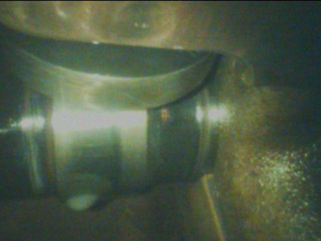

Drilled a few holes in the cooling fin closest to the connection. A worm gear clamp would probably be easier/better.
I did the holes. Looks good; looks like it is something that belongs on the airplane! Easy peasy. Safety wired to where I ran the safety wire for the old style oil filter.

As the filter and ring is concerned: It was the 2nd oil change on that oring. The filter was hand tight + 1/4 turn, safety wired. From the outside the filter looked like nothing was wrong. Upon removal I've noticed a minor dent in the oring, say four thousands of an inch. Just a dent. That was enough.
I'd say it was too loose. I've always tightened my S15 to 18 Ft pounds as per the instructions. Seems way tight to me after wrenching for 50 years, but that's what the instructions say. Glad your instincts made you turn around.
