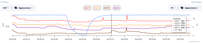

Hey Dan---this is excellent data---especially in your installed location. Somewhat confirms what we already theorized.
It would be more useful to know what it did reach.
