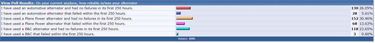

Poll Results
I didn't vote but so far 368 hrs primary and back-up B&C alternators perfect. % of PP users who had a failure in the first 250 hrs - 31%, % of Auto users who had a failure in the first 250 hrs - 18%, % of B&C users who had a failure in the first 250 hrs - 2.5%.
Shouldn't those numbers contain the words "Reported" failures? I run a PP main Alt and B&C backup on the accessory case. Neither one has failed to keep my battery charged. I did replace the PP once when trouble shooting an issue but it was still charging at the time. In fact, I loaned it to another guy that had an electrical problem and he flew it over 1000 miles to get him home. I won't hesitate to use PP.
