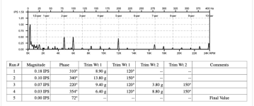

Update on my prop, I clocked it 180* and re-balanced it to .03 IPS at 2450 RPM again. Starting off the balancing, I was at .2 IPS instead of .6. It only took 17 grams vs over 60 for it to balance out. It's at .01 at idle RPMs now. Flying it has made a noticeable difference. While I still feel a bit of a rumble in the seat, the air frame itself is much smoother and more stable. The tips don't bounce anymore! Oddly, the biggest difference has been the noise level. There was a huge drop in resonance noise in the cabin and it's very welcomed!
I'd definitely recommend clocking as allowed if folks are having issues that a dynamic balance doesn't solve.

Airplane has about 70 hours on it now. Been flying well, but I felt it "vibrated" too much. (was not as smooth as my 4 cyl. Mooney) Had my prop dynamically balanced. Made little to no difference.
Yesterday, I reclocked the prop to horizontal with #1 at TDC. IT WORKED! Test flight afterwards confirmed that vibration was gone. Now it feels like a plane should! Thank you to all that posted this fix. It's a game changer.

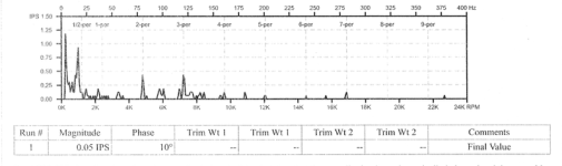

Recently I re-installed (Same clocking as before) my WW prop (Lost a shim and WW Ohio employee resealed it) and after firing it up felt the same as when it was new. Three blade composite props in my opinion almost always "feel" better than metal 2 blade so felt back to at least original install. Checked tracking and within spec but only by 3/64th of an inch. (Limit 16/64ths). Decided to remove and re-clock it 180 degrees (And while it was off install a new alternator belt) I didn't tap out a lug, gather a new tool just rotated it 180 degrees as I had the option of doing originally. I figured it would get worse, better or stay the same and give the Dynavibe an easier task. If it was worse, I would remove and reinstall back to original but figured I has a 2/3rds chance I would not need to remove and reinstall. Tracking after reclock improved 5/64ths and ground runup did indeed feel better. Test flight also "felt" better, so I was able to leave it on and now in a few weeks will get it rebalanced. I've only helped in a few other prop installs but have always had the option of installing a prop 2 ways, (180 degrees apart) and each one would be ok. Not sure what is the issue with special tools and parts needed but again my experience is limited. Seems an easy way to ensure that a prop is at least in the "better" orientation. (Remove and rotate 180 degrees)
BTW theirs an app called Vibrometer if you want to get a ball park number in cruise. Not quite the accuracy of DynaVibe but better than resting your hand on the dash.

Does re-clocking apply for fix pitch also? I had a 6A with a metal prop and it ran smooth. I currently have an RV3 with a carbon wrapped wood prop and had it balanced in flight because the static rpm was around 2050 for the Prince prop 68x79. Yes I know static rpm should be around 2200. Originally I had the same prop but with 3” less pitch with a static rpm close to 2200 but the wot rpm at 6500’ was 2830 rpm. The seller had ordered the prop I have now which was delivered an over year after I bought the plane. I’m 10 kts faster with a wot rpm of 2700 or so.
Anyways I actually flew the plane with the Dynavibe attached and balanced it at 2450 rpm. I took readings at 500, 750, 900, 1000, 1100 . . . 2600. I took readings on the ground up to 2000 rpm and the rest in flight. The ips were between.03 - .05 from 550 - 1300 rpm. At 1400 it was .14. At 1500 it was .04, 1600 (.06), 1700 - 1800 (.05), 1900 (.02). 2000-2400 (.01-.02), 2500 (.04). 2600 (.06).
From what I’m told a wood prop doesn’t have the inertia that a metal prop has which is why some of the people who run wood props add weight on front of the prop to make it run smoother. I still feel vibration on the ground especially at around 900 rpm but also in flight at normal cruise unlike in a couple of friend’s plane.
Update, rebalanced the prop today (with the prop reclocked 180 degrees) and it took slightly over half the weight that was used before to rebalance.

It took me a while to complete my flight tests with the prop reinstalled rotated 60 degrees CW.
To recall - I had strong vibrations during the flight with my two blade metal Hartzell prop and IO-540 behind from the day one I built my RV10.

Another success story... RV-10/ IO-540-D4A5/ Hartzell 2 blade prop. For 300 hours, I had an annoying 1/2 order vibration that I could feel in the seat and stick, even after balancing, rotating the prop 180 degrees and countless efforts looking for anything that I could think of that might be causing the issue.
After rotating the prop to horizontal at top dead center and rebalancing, the annoying 1/2 order vibration is gone.
As mentioned before, the 79024-S and extra 72155-S did the trick for me.
Dynavibe results before:
Dynavibe results after:
