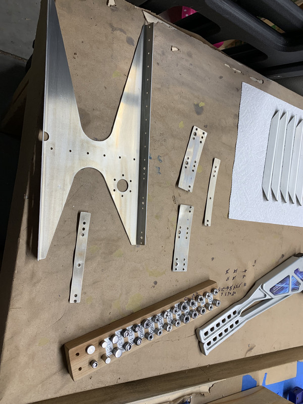

So I am getting what appears to be areas where grease was not properly removed from the aluminum and was hoping someone can't spot my problem area.
Each primer prep session goes something like this
1. Scuff parts using a maroon scotchbrite pad in a tub filled with warm water and Dawn dish soap.
2. Rinse parts and wipe them with a wet rag in a second tub filled with clean water.
3. While wearing nitrile non-powder coated gloves move parts from tub #2 to a third tub of clean water for a final rinse
4. Set parts aside to dry
5. Move parts into the paint booth (also while wearing nitrile gloves) and wipe with denatured alcohol and a clean lint free rag
6. Spray prime with SW Wash Primer or Alodine 1132 pen
7. Dry in the paint booth

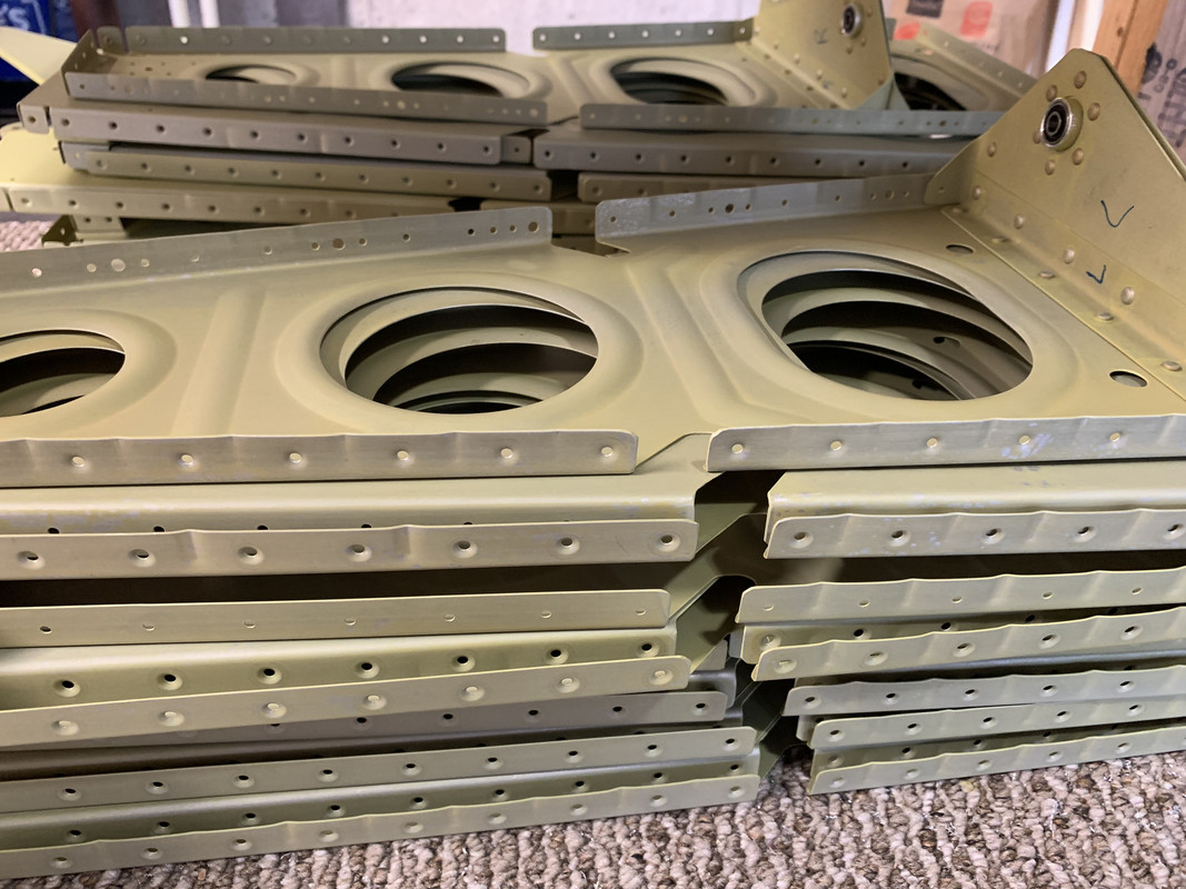

For each skin sized piece of aluminum and especially on the interior corners of the ribs, the primer is beading like the aluminum hasn't been cleaned / degreased. All the parts are thoroughly scuffed which tells me I am getting those corners with the dish soap and I can't see any water breaks during the 3rd and final rinse, but I worry that it just isn't cutting the grease. The spots aren't real bad as it seems more cosmetic (the parts are holding the primer but it doesn't appear real uniform). I do however want to figure out the issue before I get to paint since the interior primer cosmetic issues don't matter, but the exterior paint will.
Does anyone see something glaring that I am doing wrong here, or have a better recommendation for a grease cutting agent than Dawn dish soap?
I only washed just few parts with Dawn. I decided to take another tact which worked for the Akzo primer I used.
While handling parts I tried, for the most part, to make it a point to wear gloves during drilling, deburring, ect. to minimize hand oils from adding contamination to the parts.
Prior to scuffing with ScotchBrite pads, I made it a point to clean the parts really well with Acetone using inexpensive general purpose white terry cloth towels. Then after scuffing the parts with maroon Scotch-Brite pads the parts were cleaned again repeatedly with Acetone and a towel until the towel was mostly clean. You want to use white towels so you can see how much gray from the aluminum is getting onto the towels. When it is just a tiny bit move onto the next part.
Spray the primer same day the parts are cleaned preferably within an hour or so.
I've also used the same method to spray SEM primer and have not had any issues.

A photo would help diagnose. P60G2 can spray blobs if mixed too thick. Your cleaning should be adequate if the surface is water break free. If so, there's no need for an additional wipe. Try Bon Ami cleanser instead of Dawn.

So here is what I am thinking I'll try next.
1. Wipe / clean with Prep-All cleaner / degreaser
2. Scuff with maroon scotchbrite pad in Bon Ami / water solution
3. rinse and wipe in clean water
4. blow dry and move into paint booth
5. Spray prime or apply Alodine 1132
We'll see how it works. The good part about the Alodine pen is that you can clearly see if you have any remaining grease marks while applying. Much easier to correct if you do have marks than when spray priming.

I am thinking a combination of the two methods may work best depending on the part. For the small parts I prefer to clean them in a water solution since I can keep them submerged and clean them all before removing the first one from the water and starting the oxidation process. Also, from a dust and inhalation hazard aspect I prefer to scuff them wet.
For these smaller parts I am thinking
1. Scuff with maroon scotchbrite pad in Bon Ami / water solution
2. rinse and wipe in clean water
3. blow dry and move into paint booth
4. Wipe / clean with Prep-All cleaner / degreaser
For larger parts that are more difficult to submerge I am going to try the following
1. Scuff with maroon scotchbrite pad on orbital sander (while wearing a respirator)
2. move into paint booth
3. Wipe / clean with Prep-All cleaner / degreaser (lots of paper towels and rags)
Kind of a hybrid of all the methods presented in the post. I look forward to seeing how the next spray session goes. I'll try to remember to take some pictures of the results and post them here.

I have yet to see a picture of what your issues are. The log picture resolution is not good enough to see.
Water is not just H2O. It has dissolved solids, so unless you are rinsing with de-ionized water, you could be leaving solid deposits there.
I have yet to see a picture of what )precisely) your issues are. The low picture resolution is not good enough to see.

Update
I think I determined the issue. The problem seems to be letting the parts sit too long between scuffing/cleaning and applying the primer/alodine. I didn't get the prep-all yet so I cleaned a small batch of fuel tank parts in soapy water with a double rinse just like before. The only different was I immediately dried them with paper towel and applied the Alodine 1132. Even in the creases where I was having problems the Alodine went on smooth with no imperfections. I think the root of the problem was the areas where I may have not scuffed all the way through the alclad likely oxidized before I applied primer. By applying it quickly, even the poorly scuffed areas had good adhesion.
Thanks to all those that provided input.
For those that couldn't see the issue in the smaller images, here was the original issue. You can see the problem on the flanges
SNIP.... I think the root of the problem was the areas where I may have not scuffed all the way through the alclad likely oxidized before I applied primer.
Recommend you never do this. There is no reason to remove alclad to prime and some reason to leave it.
I?ve done three RVs, all slow builds and all 100% primed before assembly. I have never had anything like all the issues listed on this thread - perhaps I?ve just been lucky. So in short here is what I do:
- Fit as many parts as possible and then put then in the priming stack.
- Use PPG Alumiprep and a maroon scotch brite pad to clean and lightly scuff the aluminum. Use a lot of water to rinse (right out of the hose - not DI or such). You know you are done when the water sheets off.
- Let dry and shoot a single coat of PPG DP-40LF primer.
- I never use Alodine. The primer provides superior protection.
For the exterior I do the same but add a wipe down of all the aluminum using something like Coleman fuel and a shop towel to make sure all residue is gone before shooting the primer.
The PPG primer is amazingly durable.

Splotches
The splotches on the flanges look like areas where aluminum oxide was not scrubbed off. It's only a few mils thick but alodine won't convert. One of the many suggestions posted should work fine.
Previous post about Alumiprep works. I used it on the exterior when it was Alodined. I couldn't wash with Bon Ami in the garage and it's far too cold in the Winter up here to wash outside.

Just wanted to clarify for everyone, I have either used alodine or used wash primer on various parts, not both on the same part. The alodine 1132 pen is great for touch ups and fuel tank parts while the spray wash primer is easiest for large spray jobs. Both provide a suitable substrate for follow on coats.
I’ve done three RVs, all slow builds and all 100% primed before assembly. I have never had anything like all the issues listed on this thread - perhaps I’ve just been lucky. So in short here is what I do:

I think he means that he is scuffing through the oxidation layer. It took me a lot of work to get through the alclad laye with 100 grit on a DA when I tested. Your arm would fall off before you could go through it with a scuff pad. The maroon ones are 400 grit equivalent.
WHen he didn't mechanically remove the oxidation layer, he got adhesion failure, which is expected.
