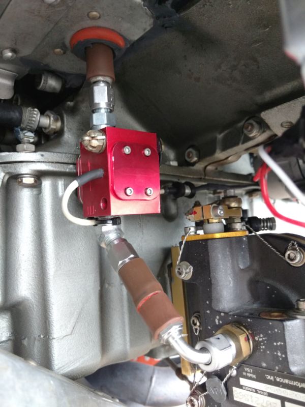

Mine is on the line after the servo on its way to the spider, right in front of the oil pan. It is suspended on the fuel line with a couple inches of play for vibrations on both sides. It is right side up with the wires going straight up as their directions say. And I put a big piece of fire sleeve on it to protect it from rattling on anything like the engine. And also to contain drips if it leaks. You can see it here: http://www.mykitlog.com/users/category.php?user=sglynn&project=607&category=4664
Only 5 hours flying so far, but so far works perfectly.

Mine is on the line after the servo on its way to the spider, right in front of the oil pan. You can see it here: http://www.mykitlog.com/users/category.php?user=sglynn&project=607&category=4664
That's as good as anything I've seen, assuming the servo is installed outlet down. Adels at the pan gasket line, no load on the flow divider hardware. Good thinking.

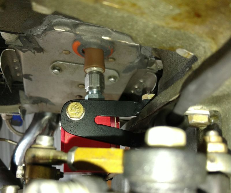

I have an AFP purge valve attached to the flow divider, so a red cube hanging in the vertical feed hose adds to a load path cantilevered more than with just a divider alone. It's not insignificant; there's a pipe nipple between the divider and the purge valve. Long time back there was a mandatory AFP bulletin to replace the aluminum nipple with a steel nipple.

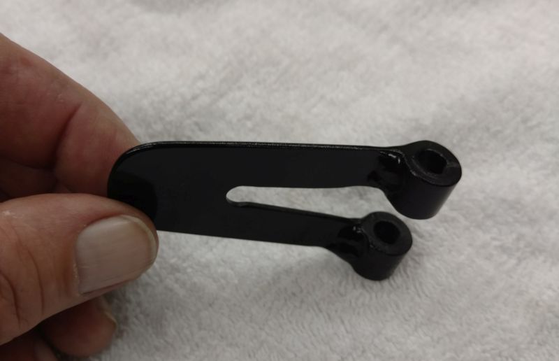

So, I opted for an hard bracket to hang the cube from a sump bolt. Will vibration kill it? I dunno, we'll see. It was on a vibrating firewall for 800 hours.
BTW, in the old location between the electric pump and the engine driven pump, it was inaccurate at idle, or with the electric pump on. No such behavior in this new location. Yes, I know the wires do not point up. Doesn't seem to care. Given the internal construction, I suspect they can't point down.
