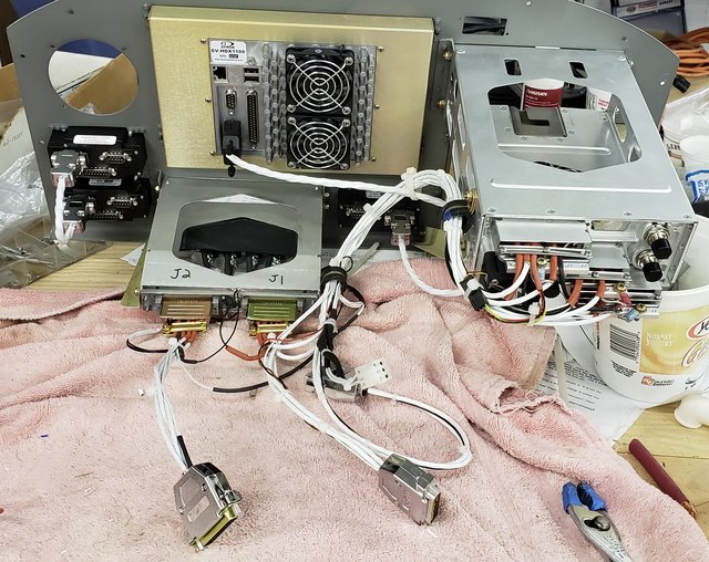

My first wiring behind the panel started out reasonable, but evolved into a rat's nest after 15 years, although not as bad as the OP's picture. After 15 years, I redid the entire electrical system, at least all of it between the firewall and the panel. I vowed that I wasn't going to climb under the panel again for making modifications, etc. I built the entire avionics wiring harness while sitting in the aircraft seats. This picture shows how every single avionics harness come through a central "node". I wanted to be able to pull any connector off from something and bring it out aft of the panel, should I want to add/change something. The view is towards the 10 o'clock position, with the connectors out of the picture's lower left. This is not the final product, lest someone notes that things are not tied down enough:
ACtC-3eCRfA6lRh6ofmZmbCE127c5L37T361LxxBUwuPhz3_2o6w0k_Qt6QIctNecxAGTYSJ-5ShTVBV0Rm7kong288EXSSyysePeYHIn2RbbAQdeMAkpsbv3eu_Y7JpwoILzEFekzobRVXmG3AmCsiFfQwyXQ=w800
Another view which shows the long bundles:
ACtC-3cpGAgqUfEQn5kXHpDQmhGxLDdTfrZrK3uj707hqOsmD7XupLngin_32KJomCcnukpFyBbQld4JRyI8UzRoRpbOoCIdeD4pvXLZrqGfQEkakMhnlYKIqtAmJ4PiMRHLJ3sCJXou4KYgv2EP_83MiQT8TQ=w800
I do not seem to have a picture of the bundles in final position, but without the EFIS in place.
This scheme might have added a few pounds of wire, but it is worth it.

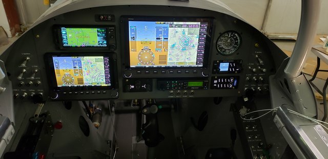

Below photos are how I did this in my RV-8. The RV-8A and RV-10 followed the same approach.

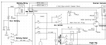

I wholeheartedly support the idea of documenting your wiring with a spreadsheet. It has many advantages: 1) It is much easier to keep up to date than a schematic; 2) It is searchable for finding things; 3) It is much more compact than a huge schematic; 4) If you are starting from avionics, it is easier to add/integrate the rest of the plane's electrical wiring in the same data base.
I don't have a wire book, so can't comment on that, but I think it's very useful to create a schematic regardless (actually, several schematics...buss, engine, lighting, network, whatever...). I think they're very useful for debugging problems. As a simple example, I have lighted rocker switches for everything...in the ON position, the light should be on, and off when the switch is off. One day, I turned on the Master and the Alternator switch also lit up. That's odd...how can that be?
A quick look at the schematic told me exactly where to look. Following the wires I figured something must be wrong with the alternator, allowing it to backfeed the switch light. A quick check on the appropriate leads on the alternator showed that an internal diode had failed, confirming the diagnosis. Alternator R&Red under warranty.
Sure, you could figure that out with a wire book, but it was a very quick debugging task with a schematic.

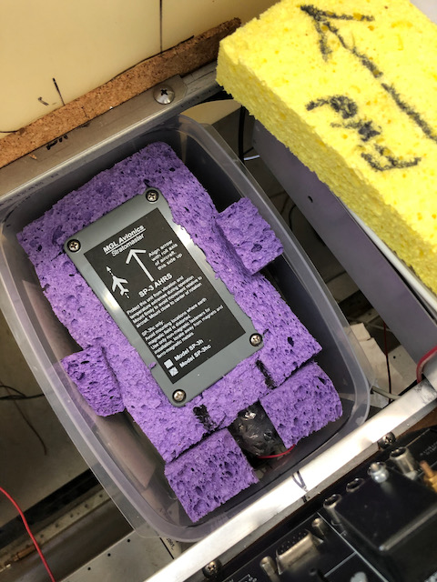

Got me thinking of a recent find... here's a picture of an AHRS mounted in sponges, mounted in a Tupperware container, which was mounted behind the panel. This was from a VFR Sonex project at the local airport. Needless to say, we replaced this setup.
Yeah, I would say that the attitude reference information from that box is going to be a little 'soft'.
Hey, at least he marked the sponge "Forward" :)
I'd have to at least take it up once just to see how well this "system" actually performed, for s**ts and grins LOL!
My Lord, the things people come up with...
Looks like whoever put it there was giving the instructions printed on the module a college try.
nail clippers
I've been cutting my zip-ties with nail clippers. They put a very slight curved cut on the end in stead of two sharper corners - not rounded very much.
Let's see now, the primary purpose of a sponge is to retain water.
Nope! No chance of corrosion here. The sponge will pull all moisture away from the module. Right?
hahahahaha
What in the sam h-e-l-l were they trying to accomplish?!?
At least they marked the sponges direction to ensure it went back in the same way each time. lol
Next time: Pack the unit in desiccant beads, not sponges. Problem solved!
The sponge approach is all wrong. He shoulda used white rice, of course! :rolleyes:
