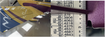

Hoping to trouble shoot this. I have a new to me rv14, and at maxium throttle, 7500 to 10500 feet, I'm only gettin 158 knots maximum TAS. This is with varied fuel flows, rich, lean, max power rich, and varied prop speeds, with 2480 RPM seeming to be optimal for max speed. Any suggestions? Wondering if timing is not quite right, though doubt it. Max throttle position not actual max throttle? Wheel pants and leg fairings seem to look by eye properly aligned. No excessvie drag items. The motor is smooth and has great takeoff power, just not seeing the top end and cruise the Vans website qoutes. It is an i0390 with 210 hp, dual p-mags set up.
Or is this in the ballpark for average? Looks like 167 knots is the expected max on this motor setup. It only 9 knots, but...it's 9 knots!
