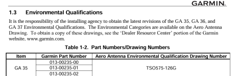

Can someone post where to find this document? Seems restricted to "Dealer Resource Center". Some TSO WAAS manufactures post 85 C or 185 F max operating temps but cannot find out what Garmin states. I'm sure for those that follow Garmin antenna specs to the letter one has this.
Along with meeting section 2.2 (Antenna mounting location) of the install manual any other specs Garmin publishes elsewhere ?
