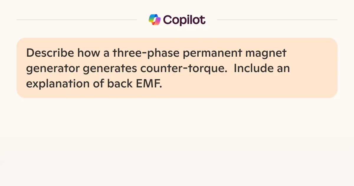

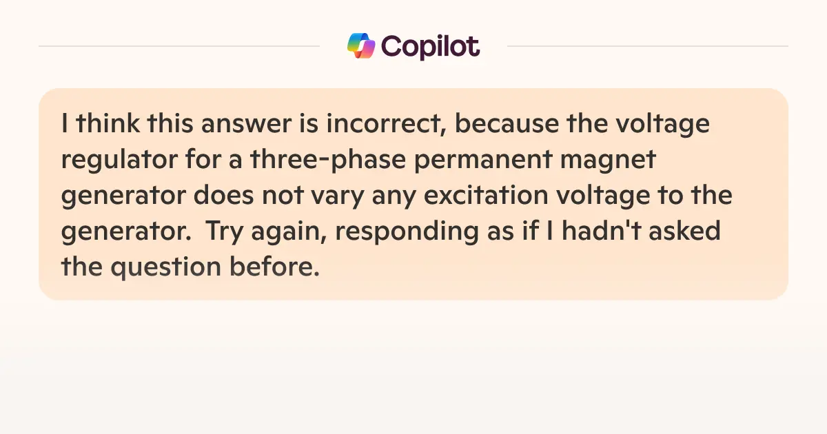

Then I asked about regulating the output of a three-phase permanent magnet generator, and there was some hallucination on the part of the AI, so I tried again...

To pull this together, it sounds like @Freemasm is thinking the PM generator works like this:
2.3. Simple shunt/dump‑load regulation (common in small systems)
  • The three‑phase output is rectified to DC.
  • A comparator monitors the DC voltage.
  • When the voltage exceeds a threshold, a dump load (e.g., resistor bank) is switched in (often via PWM).
  • This increases electrical load on the generator, increasing counter‑torque and clamping the DC voltage around a setpoint.
Key idea: Regulation by controlled loading, not by field control. You “burn off” excess power as heat or useful load to keep voltage from rising too high as speed increases.
But, based on my testing, I'd say the MZ works like this:
3. Active rectifier–based regulation
Instead of a passive diode bridge, some systems use an active three‑phase rectifier (MOSFETs/IGBTs in a full bridge):
  • The rectifier is PWM‑controlled to shape the generator currents and control the DC bus voltage directly.
  • The controller measures DC bus voltage and generator currents and adjusts the duty cycles to maintain a reference voltage, while also optimizing efficiency, power factor, or torque ripple.
In this case, the “voltage regulator” is essentially the control algorithm driving the active rectifier. Again, no rotor excitation is changed; all control happens via switching and current control on the stator side.
The "counter-torque" (seen as mechanical drag or load) is only happening while the MOSFETs are turned on within the PWM duty cycle. While the MOSFETs are turned off within the PWM duty cycle, the generator is open-circuit and has no drag. That's how the drag varies based on output power.
