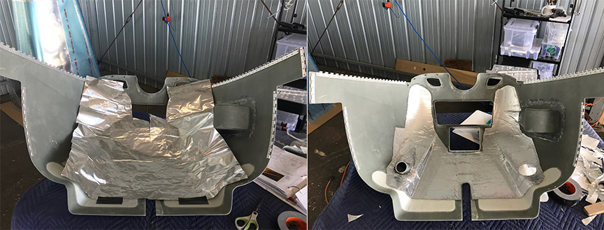

Also, in the finish kit plans there is a step where you put "EA EXHST/COWL SHIELD" on the bottom of the cowl. The picture seems to imply this is a pre-fitted/pre-sized part. I looked through the finish kit inventory sheet and don't see this. Is it part of the engine kit? Something additional I have to get?

On my plane where the exhaust is close to the cowling, I used Aluminized Heat Barrier from Aircraft Spruce. It has performed perfectly. If you go that route, I recommend using 3M Primer 94 to prime the cowling. You let it dry and it makes adhesives really stick. Also, seal the edges with red RTV.

The cowl shield came in a roll for my iS, which needed cut and applied to the areas illustrated in the KAI photo.

As far as the shield goes, I think it came with my original finishing kit for the RV-12 or the engine kit. Don't remember, but its' a large square sheet that you need to cut and shape the best you can going by the photo in the plans. There are no measurements given by Vans. Just need to wing it.
