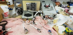

It's time to cut the panel! I've already cut off my sub-panel to panel support ribs to relocate them to either side of my center stack. Anybody care to share pictures of how you supported your center stack trays? I actually only have one tray (audio panel) to put in now, but I think I will go ahead and cut the panel opening for a future IFR GPS. I'd like to create a setup that makes it relatively easy to add the GPS tray when that day comes. Having never done this before, I'm not even quite sure what the "normal" method is for supporting everything in a typical center stack.
Tip Up or Slider? I'm guessing it might make a difference.
Anyway, here's how I did it on my slider. Just some angle around the hole I cut in the sub panel and more angle attached to the racks, which are also screwed to together at the back so they all make one big stiff box. Ignore that box on the bottom- that's the remote xponder mounted sideways under the radio rack behind the panel.

Oops, it's a tip-up, but seeing how you did yours still gives me some ideas. So are your racks dimpled to accept a screw head on the inside then, or am I not seeing it quite right?
You're seeing it right. The Garmin racks come with bunch of holes pre-dimpled so you can screw them together a bunch of different ways. The fiber lock nuts on the top and bottom of the diagonal brace are on screws that are common to both the bracing and the racks. If you look close you can see through the rack and see a screw head thats doing the same thing on the other side.
Here’s how I did mine, just two aluminum angles to screw the trays to and a diagonal brace on each side. This is pretty typical of certified installations also. I also made a shelf to mount my GADs to.

If you need to extend a long tray (e.g. GTN-650) through the next forward bulkhead as is common on the RV-10, you can add a forward support to the tray by adding a couple of nut plates.
Take the two screws out and the tray assembly comes out with rest of the panel in just a few minutes.

That’s quite a bit of unsupported weight on a tip up panel, suggest you install a support on the sub panel.
Define "unsupported". The panel is 0.063", fastened to the structure with a vertical rib on either side of the stack, plus the center column to the floor. I've seen way heavier radio stacks mounted the same way in certified training airplanes that have endured thousands of hard landings without issue. I don't know what kind of loads you think it will be subjected to, but from my personal experience, it's more than adequate.
While Walt and I rarely agree on anything, I suggest he has a point. See if you can fashion an anchor point on the foreward side of the stack. While the angle you have will most likely be fine, the stack acting like a pendulum could promote cracking over time. This is the same reason I never hang an oil cooler off the baffles.
I have cantilevered one install, a single GTN-650 on an RV-8 panel, but not a multiple radio stack. Trying to anchor the forward side of the 650 tray and still make it easy to remove the panel as an assembly proved problematic.

Unsupported as in able to flex around the limited panel attachments to the airframe. The arm/weight of the radios will tend to bend the panel.
Try installing the panel and placing a 30lb weight on the radio stack and see what it does. (5lbs x 6G's)
Having worked in the certified world a bit myself, panels are always supported at the top and/or sides somehow.

So others in the future have yet another picture to look at to sort out the options, here's what I ended up doing to support my center stack. Aluminum angle riveted to the panel and subpanel to support braces for my audio panel tray, as well as room in the future to support a future brace for my IFR GPS below. I also added a top angled support from the subpanel to the top of the panel to provide more rigidity. It ended up being a great place to adel clamp wire bundles going from the left to right side of the panel (because it's a tipup, I had to drop it down on the subpanel to clear the tipup frame).
