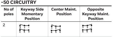

Trying to wrap my head around leaving the two lower contacts empty. Shouldn't the bottom screws have P-Lead on one side and ground on the other side? Stein photo shows the switch as "ON-ON-ON Momentary" but this photo would imply the P-Lead is ungrounded when away from the cockpit. Concerning to me as I move the prop on a very Heat Soaking engine to attach the Tug. Feel free to correct me, Ed
For the Honeywell TL series switches with the -50 circuitry, when the switch is in the opposite keyway maintained position "down", pins 3&2 and 5&6 are connected, which in this case would be grounding the mag, and applying power to the Emag. In the center maintained position, pins 1&2 and 5&6 are connected, ungrounding the mag but leaving the power connected. With the keyway side momentary position "up", pins 1&2 and 4&5 are connected, leaving the p-lead ungrounded and also disconnecting the ship's power to the mag. Attached pic is from the TL series datasheet.
Exactly. The switch is actually installed upside down. Notice the pin numbers.
It does mean in "OFF" position, the P-mags have power until the source is turned off. That's how they go into program mode. Turn on ship power with the P-lead shorted to ground. They switch to run mode as soon as any rotation is detected in run position.
Thanks for this example! So as I see it now the terminals 1 & 4 are being utilized and I may have been confusing terminal locations with toggle positions when looking at BWAGNER post # 6 above (Stein drawing 1&4 not in use).
This is an excellent example for SINGLE PMAG testing as when the toggle is lifted to the momentary position at idle the engine should quit, BUT when lifted to momentary position above 1200RPM it should keep running normal and uninterrupted.
In order to test with TWO PMAGS each one will have to be turned OFF to down position in order to test the other one.
