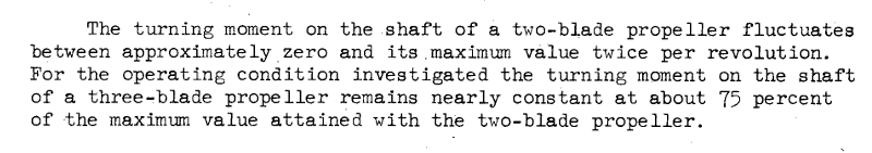

Another consideration is the extra stress and vibration of a 2-bladed propellor when the pitch or yaw angle of the aircraft is changing. From https://apps.dtic.mil/sti/tr/pdf/ADA380456.pdf:
I recall that many years ago this was raised in connection with an AD on propshaft inspection for some Lycoming engines with hollow propshafts, because it was suspected that the increased stress when using a 2-blade propellor hadn't been taken into account.
