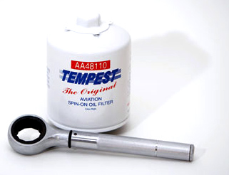

I also note that both Tempest and Champion have specific oil filter torque wrenches available, might be a tool I'll be investing in instead of falling back to older methods as I now see there IS a difference between the 2 product lines.

How are you torquing it? I use this guy and have never had any issues:
