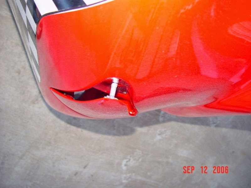

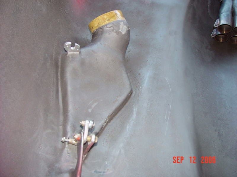

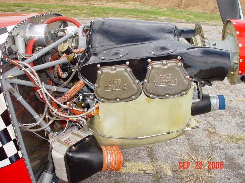

Not a NACA, but it is a scoop
Alan Judy's RV6 - it does not open very far, but he said it cools like a monster.
