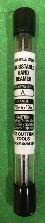

Ex valve sticking (again) 😳 last year I used a 1/2" ball hone and I'm thinking it wasn't aggressive enough. Apologies for starting another sticky valve thread
well, enough experience here with freeing valves from C90s to O-320/360s and 390s, and though all due respect to gone Bob with whom I argued several times about it, wouldn't use a ball hone for this job... so, at the risk of repeating myself, I've always used an adjustable reamer for the job, with excellent and repeatable results.

The ball hone could work just fine. However how it is used, and how much deposits vs guide material is removed, could end up being highly variable. Really the only way to tell would be some of pin gauge or inside micrometer.
I don't think it would hurt to repeat with a reamer and dress with a hone after that.

The ball hone does take a bit of time to do its job. Possibly you went too quick. Next time be sure that you don’t stop honing while the guide ID is still black. You should be seeing bronze or shiny metal before stopping. It is not aggressive like reaming. Going a bit too far won’t take off any material.
which, if the reamer is an adjustable one and is properly adjusted, less aggressive since it won't remove any of the guide's material, but only the carbon crud.
Applying grease on the reamer and minutely adjusting it whilst working should not attack the guide.
Done carefully this method will also warrant the concentric and cylindrical properties of the guide, which a honing ball will not.

A few thoughts I've never seen mentioned here. We always get into the debate of honing vs reaming, but no one ever makes a compelling case for one vs the other. Reaming makes a perfectly round hole with a smooth finish. Valve guides typically don't wear evenly; due to the rocker arm tip sliding across the stem, the wear is somewhat oblong. So, while the newly reamed bore will be round, the top and bottom of the guide may have carbon remaining at the ends.
Of the honing adherents, how many of us stroke in and out quickly enough to generate a cross-hatch finish? I do, because I'm trying to emulate a cylinder wall finish. And cylinders are honed that way to hold oil on the surface for lubrication.
After reaming, we have a shiny and smooth hole which shouldn't hold oil as well as a cross-hatched honed surface. Is that a problem? I don't really know.
Like so many things here, technique is important. And reaming may be easier to do in an effective way without training? With honing, it's critical to flood the surface with WD-40 etc, and to do it long enough to get all the carbon out. And to stroke in and out quickly to get a cross-hatch finish. And to clean out the remaining abrasive thoroughly. The ball hones also follow all of the surface, oblong ends and all.

I've seen new valve guides not installed in their respective cylinders, and those had no cross-hatch pattern. Which doesn't mean having some is a bad idea.
The point I'm making about using the adjustable reamer is NOT to ream the guide itself, but just eliminate the crud that had the valve's stem seize, and that is usually a small annular surface on the combustion side of the guide. Properly adjusted, the reamer will not or only lightly touch said guide, and shall not remove any material from it. And that is a fundamental reason for me to use an adjustable reamer and not hone-balls.
Now they might be more reasons to really ream the guide itself, but that is usually not the case for sticking valve, and I've only seen only one case where I had to ream the guide as it too was severely affected by lead deposits.

All guides are delivered under sized and SOP is to ream them to final size after pressing them into the head. This is done because the guide is somewhat thin and will lose a bit of its shape when pressed into the head. They are not honed or at least that is not sop.
