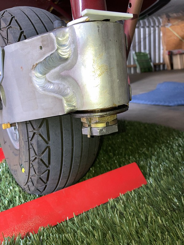

I am trying to track down a slight shimmy when I land and apply the brakes. I have gone through the mains, warped rotors, wheel bearings, tire roundness, it all checks good so I am focusing on the nose wheel.
I have rechecked the break-away torque but notice the castle nut moves within the cotter key when the fork is moved side to side. I don’t recall noticing this before and would think it would eventually wear the threads.
The shimmy started shortly after the new nose leg and fork was installed.
Advice?

I think this is to be expected, as the friction radius of the nut is smaller than the friction radius of the belleville washers. I saw that as I was building in the late 90's, and found a split collar with the 1.25-16 threads. I had to machine a chamfer on it to clear the wheel fairing. I have looked on and off for a supplier of this collar, but have never found it again. Bottom line - it is normal. Probably good to replace the cotter pin from time to time.

I found this play around the cotter pin to create a 5 lb difference in force left vs right. I didn’t like it, so i used a #6 flat head screw/nut instead of the cotter pin. Keeps the nut from loosening in one direction and tightening in the other.

I had this problem and finally installed a GoPro under the wing to look at it after trying everything from tire pressure to balance, etc on nosewheel. Turned out to be left main gear, not the nosewheel. Once something like brakes starts the movement of the main to the rear, it then wants to return to the front, then the oscillation begins until a lower speed is reached. The natural resonance of the gear leg and the mass of the wheel, tire, pants, etc. causes this once excited. Tire pressure a bit lower than recommended will dampen it. I run about 30 on my RV9A
I am not saying that stopping the castle nut movement is necessary but this is my fix.
I machined the "crowns" down .080", still room for the cotter key. I completely removed the crowns on another nut to use as a jam nut. I had these nuts laying around so I re-purposing them rather than buy new ones specific for the job.
The cotter key still does its job, and the jam nut keeps it all stationary.
