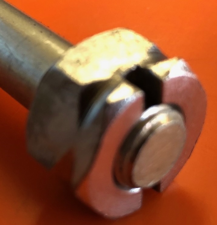

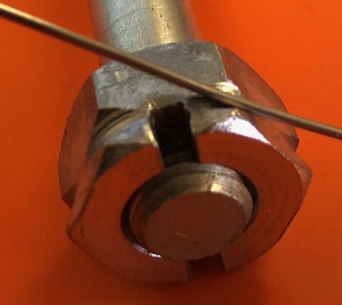

....I agree about it being a real pain! Especially with this particular propeller, as it appears the
relief cuts milled in the hub, where the nuts go, aren't deep enough to allow clearance for the
safety wire. We have installed many of these, and I now do this simple modification to the
nuts by machining a clearance groove a bit larger than the safety wire (see pics) prior to the
first installation. This can save you many hours of frustration, and your finish job will be neater
and cleaner, I promise. Thanks, Allan--:D
