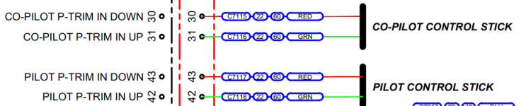

One thing you can easily check before you get the AV-60000 back from Van's is the control stick trim button wiring. At the 50-pin DB connector that attaches to the rear of the AV-60000 find the pins illustrated below and test for continuity to ground with your ohmmeter buzzer function while pressing the appropriate stick buttons. This will prove the stick buttons function properly.

Both of these diagrams are from page 8 of the WH-00134-3 Schematic, which shows the AV-60000 Power Module.

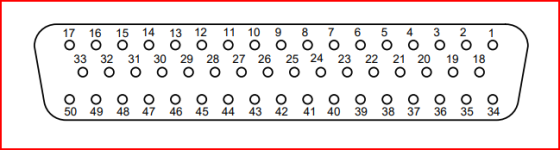

Ok - did all this. Got no continuity between any of the indicated pins while holding down the appropriate trim buttons (this was with one DVM lead grounded to the airframe and using a spare pin inserted in the other lead). Tried disconnecting the DB9 at the base of the stick to the AV 60000 and no continuity from there either. Opened the harness-end DB9 and it is wired correctly. Could Stein have miswired the DB50 plug? Not really looking forward to taking that apart.
Are you positive you are testing the correct sockets in the 50-pin connector? Sorry, I had to ask. I've seen a wire or two mis-pinned, but not all four in a particular circuit.
This is the 50-pin connector numbering if you are holding the assembled backshell that plugs into the AV-60000.
It won't hurt anything to tone-out the other pins in the connector until (if) you find the pins that do have continuity. The nice thing is they are color coded and numbered if you do have to open it up and swap wires.

So - some unexpected findings (aren’t they always?). I pulled up the seat angle panels on both sides and checked continuity again. No issues in wiring harness to 50 pin AV-60000 connector. Checked stick wiring for continuity at the DB9 connectors at the bases of the sticks. After disassembling the connectors, found a broken ground wire at the pin crimp on the copilot stick, and a broken ”down” trim wire at the pin crimp on the pilot stick. I checked all the other pins and button functions on both sticks, and they all are working. I think I must have been a little too vigorous with my crimps when I installed these connectors 8 months ago. All back together now and waiting for reinstallation of the AV-60000, which arrived from Van’s yesterday. Unfortunately, it’s at my home in Virginia and I’m at the airplane build in NC, so will be a couple of weeks before that happens.
