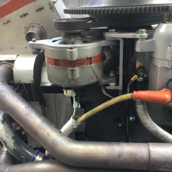

What is the little canister device at the 12 o'clock position with wire that runs down to nut at 6 o'clock position? Not on alternator that I am replacing. Is it needed...or should I remove? Alternator has lasted 15 years, 850+hrs
ry%3D480
Condenser, used for noise suppression. If you don't have a new one (not generally necessary) then I would not use an old one as they do go bad.

Just adding this to the thread. The alternator is a 32A, from an 80s era Toyota. I'm using a B&C LR-2 external regulator. I'm thinking of putting a larger dia. pulley on it when I get a round tuit.
I would leave the pulley alone. It looks like your ring gear pulley is the smaller one so it won't overspeed the alternator.
Thank you. I didn't know the ring gear pulleys came in different sizes. I didn't want to mess with it anyway!
