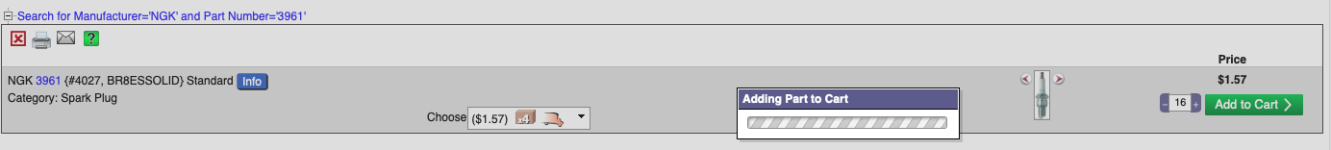

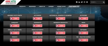

…but the manufacturer has discontinued the BR8ES 3961 plug.
Dang - they’ve only got three plugs left at that price….Just ordered 3961 from Rockauto for a $1.17 ea. plus shipping.
I ordered a bunch of the BR8ES from Aircraft Spruce this week. No stock issues.
These posts may run in evil circles.... the original post is years old. Then I see it in today's list. Makes me wonder why.
So I read the whole thing... which of course has gone on another tangent about heat ranges and so forth. It wanders back to the original question, are they discontinued? Seems not.
