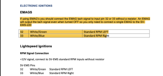

I was just going to start a new thread about my issue but given the subject, this seems close enough so I'll add to it.
I bought my RV-10 about 2.5 years ago with dual Lightspeed ignitions. Between some issues with what eventually turned out to be the mini-sensor and strong recommendations from other RV owners, I decided to work with an A&P to swap the Lightspeeds out for Pmags. We wired the tach outputs from one Pmag to what seemed like the one of the tach inputs to the AFS 5600 (which the Lightspeeds were connected to) per the instructions in the AFS install manual (screenshot below). The engine seems to run fine and the tach indications are normal at low RPM but on takeoff and high RPM, the tach reading is bouncing all over the place and showing as high as 2800 (see chart below - RPM is in green) - the normal takeoff RPM is around 2650! The propeller has not been touched as part of this work and the sound is not changing so it looks like the prop is fine and it seems to be an issue with the reading. The RPM reading settles down somewhat once the RPMs are reduced below about 2400 RPM but still bounces around more than it used to. The A&P thought it might be an issue with the crimp and took care of that today but the problem persists.
Any suggestions on what we should be looking at as we troubleshoot this issue?

The below chart is from when the plane had the LSE ignitions. As you can see, it tops out at about 2650. Looking at the zoomed timeline, I do see some "glitches" in the RPM reading even with the LSE but in general, it was a lot more stable.
Question - if nothing other than the ignitions were changed, is there any reason that the prop settings (low pitch, max rpm, etc. settings) would change? My understanding is that the tach wire from the Pmag is purely an output to the EFIS.
Perhaps, I can switch the tach input (to the EFIS) to the other Pmag and see if it looks any different. I am going to call them to see if they have any ideas too.

Finally got the tach issue resolved! We had removed a small circuit board when we removed the two Lightspeed ignitions and then directly connected the output from one of the Emags to what appeared to be the correct tach input for the AFS EFIS thinking that was the pin that took a 12V tach signal (because the Lightspeed manual said it generates a 10V tach signal) - and we needed only one because the Emag generates a tach signal even if it’s turned off (p-lead is grounded). On the other hand, the Lightspeed ignition does not generate a tach signal if it’s turned off so it needed to have both tach outputs connected to the EFIS. After checking with the previous owner and then finding/reading the correct documents for my "legacy" AFS 5600 (with the built-in engine monitoring), I figured out that the small circuit board was from AFS (71420L RPM Interface Board) - it combines two tach signals and generates one input signal for the EFIS AND steps the voltage down to 5V. So, the output from the circuit board went into the pin for the 5V tach input for the AFS (and not the 12V as I had assumed).
What we should have done (and did) was to put the circuit board back in and just replace the two Lightspeed tach outputs into this circuit board with the Emag tach outputs because everything else stayed the same (5V tach output to the EFIS). As we discovered today, the 12V tach input on the AFS (pin 33) did not even have a pin connection so it was unused. The clean install would have been to connect one of the Emag tach outputs to the 12V tach input on the EFIS.
