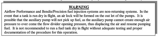

Why did the engine not relight?

Not saying this was the OP's issue, but a warning from Airflow Performance:
Something else to consider if a tank is run dry or unported. Excerpt from the Airflow Performance Auxiliary Pump document:
wow, had not seen that before.
its not been a problem for me, but that seems like quite an issue as tanks get run dry all the time.
If you have the AFP purge valve, a full return system, and have the presence of mind to open the return valve, then you can probably get the pump re-primed if it's run dry. I personally just choose to not run a tank dry, since I'm not much of a risk-taker.
