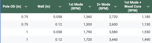

As for the pole mount, most folks run a standard 3/4" tube that will resonate at specific RPMs. The primary vibration comes from propeller imbalance (at a frequency of 1x the RPM) and the engine firing (at 2x the rpm frequency). If you're flying at high angles of attack or yaw you might notice an increase to the 2x rpm frequency from asymmetric airflow over the propeller. In a perfect world, the camera pole mount would be stiff enough that it would have a resonance frequency higher than all of the engine and prop vibe, but this can only be achieved with a very stubby pole or using high modulus carbon fiber (way to pricey). I ran some calcs to see what the resonance frequency would be of various different pole sizes, and none of the metal ones would avoid hitting the resonance frequency. So I opted for a 3/4" pole with a wood core bonded on the inside to reduce amplitude of vibrations. Results work well, it does resonant at ~1100 and ~2200 rpm but the amplitude is much less than when I had just a hollow rod.

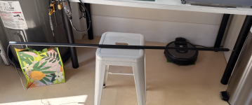

Hey Nick, I am experimenting with a hollow carbon fiber tube. 2mm thick, 1m long and 20mm OD.
I want to try a hollow tube to run power through it, so I dont need to worry with camera battery. Here some pictures:
Screenshot 2026-04-14 at 2.20.14 PM.pngScreenshot 2026-04-14 at 2.21.59 PM.png
My plan is to drill a whole in the fiberglass wingtip and permanently attach a hollow 20mm ID carbon fiber tube as a "sleeve" to the camera pole. Using the headset plug to automatically connect power to the pole.
So whenever I want to film, I remove a cap from the sleeve tube and stick the pole into the sleeve. :D
I will post updates as I progress. Waiting on epoxy and USB-C connector components to power the insta360.

I use the FlightFlix mounts on the wigtip underside with their 36 inch aluminum pole. Works well except for some resonance shaking. I addressed that by wrapping longitudinally with duct tape and then sliding some 1” marine-grade heat shrink tubing over that , then hitting it with a heat gun. Definite improvement. I’ll see how it goes for awhile but I’m contemplating filling the inside of the tube with some expanding foam and maybe some lead shot. I’m not committed to that process, fearing rupturing the pole. We’ll see.
Don't add lead shot - you want something to dampen the vibes and not add mass. A wood fill or expanding foam will work well. Wood is best because it dampens super well

i want to address the resonance frequency. Adding mass will do that if the stiffness measures I’ve already taken prove to be insufficient. The tape and marine grade heat shrink were easy to do and seem to be pretty effective so far, but if they prove not to be, Inserting a dowel turned down to the right diameter and some epoxy would be another thing to consider although I’m optimistic that it will be unnecessary.
I am not sure I follow your plan. Resonance frequency is proportional to sqrt(stiffness/mass). So just adding mass (lead shot) will drop the resonance frequency? In theory if you made it so low (resonant at ~100rpm) it could act isolated. The tape + heat shrink is good because it acts as damper so it reduces amplitude of vibrations when the resonance frequency is hit. The wood fill (dowel + expanding glue) is an effective damper for minimal mass increase.
