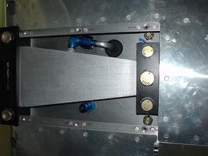

Marty - quick question, why is your brake line outside like that? Do you have a photo from a bit further back? That's different from mine which comes out of the gear leg and then goes up into the cockpit.
Some guys run the hard lines under the gear leg, then up the other side. I think that makes it a little easier to work with the hard lines.
It really isn't outside; it's routed around the gear bracket then into the gear tower. This was done a long time ago; I don't remember why I routed it this way. I'm thinking it had to do with obstacles in the tower or maybe that's where the factory provided the hole.

I used a similar approach when I plumbed my legs 10 years or so ago and documented it here:
https://vansairforce.net/community/showpost.php?p=1117862&postcount=1
My reasoning was to be able to use the stock bulkhead fitting locations in the fuselage.
