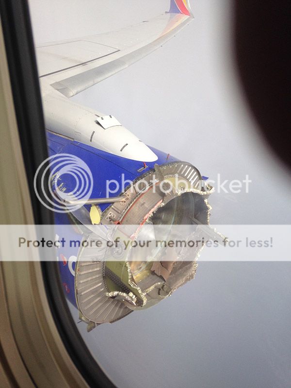

Excuse the melodrama, but my wife and I had 2-3 minutes of sustainable oil left when I landed. If I had been just a few miles further south I would have been off airport and choosing between sheep trails, lava rock, or forest. Having not known that I was going to be dead stick until it seized. (Not that an abandoned airport on the Rez is far from off airport).
Rant off. Thank God nobody has gotten hurt (that we know of).

While not strictly a reporting requirement, would you tell the FAA if the cylinder head on your engine departed when the engine was at 50% of TBO?
Point being, unexpected failures at low in service times indicate an engineering or manufacturing problem. In the case of these governors, they are type certificated parts, in some cases installed on type to certificated engines. The SB referring to experimental aircraft with electronic ignition and higher compression is bogus on all three items. They are doing the SB on my governor because its serial number is on the SB, but the model number is not, it is on an RV-10, but the engine is certified, with stock compression and mags. Only the Mt prop and the airframe are not type certificated.
