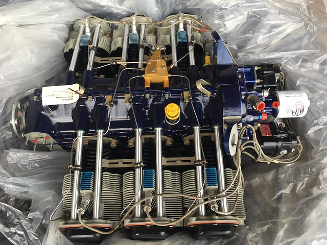

So the engine teardown has begun. As expected, the prop gov drive assembly is toast. What wasn't expected was apparently one of the exhaust valve tappets broke and ping-ponged around. The good news is it doesn't appear that the case has been cracked, but they are going to dye it to be sure -- hopefully I will dodge that bullet. So far we know all of the the valve springs will be replaced and all the other components will be pulled and measured for service limits. I would expect that additional valve train components will need to be replaced. More to follow....
Ouch. What rpm did it hit during the overspeed, and how long was it up there?
3250 for 10 sec. I was flying a missed approach at the time and actually did not know the magnitude of the overspeed until I pulled the engine data log the next day.
Wow - I wouldn't have predicted that 3250 rpm would lead to a failure in the valve train.
Wow. I wonder what will be found in my engine. It will likely be late this winter or early spring till I have time to tear into it. It went to 3496 RPM and was over 2700 for a while but would have to look up the duration. Pretty sure it was less than 10 sec. going from memory.
Well I'm not going to jump to any conclusions one way or the other. The tappet failure could be purely coincidental, or perhaps it was on it was already well on its way to failure and the overspeed just accelerated the process--who knows?
My only advice is if you have an overspeed, read Lycoming SB 369L very carefully, and contact your prop and rotating accessory manufacturers for potential impacts. In my case my prop, and 1 of 2 of alternators exceeded specs and had to be replaced. I also went ahead and replaced the 2nd alternator as it was real close to the manufacturer's max limit and as I have an all electric airplane and fly IFR a lot, I deemed it prudent to replace.
Well **** happens, and so far my insurance underwriter hasn't given me a reason to panic--yet. Right now the estimate is north of $21K and that's before they find anything that needs to be replaced outside of the prop.

Update for all those that have been inquiring how this worked out.
I opted to buy a new engine so the Insurance paid the estimated over speed inspection cost along with engine removal and reinstallation. They also paid for the new prop. Sure it didn't pay for every thing I am out of pocket such as hangar rent at the remote airport and travel back and forth but I am pleased with the service provided by Hallmark.
The new engine now has ~5hrs total time on it. Time will tell how it works out.

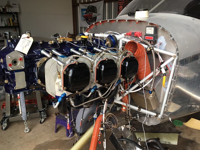

Epilogue....
So it's been almost 5 months since my prop gov self destructed and shelled the engine on my RV-10, Finally got it back from BPE this past Wed and got it mounted today:
Now just a few things to tidy up (fuel and oil lines, throttle body, air box, exhaust, primary alternator, starter, sensors, p-leads, electrical wiring, control cables, ring gear, prop, prop governor, and baffles) and we're back in business.
It was supposed to be on the in the paint shop right now getting finishing touches on it's paint job, but I had to give up my slot. Luckily I was able to swap with the guy behind me so I'll get it painted in March.
Nice. Don't be a moron like I was and try and crank it with the fuel still shut off. The first flight will almost be as memorable as the original. It feels great to get back "normal", but I must confess that I listen more to the engine now than i did before ... perhaps I always will.
