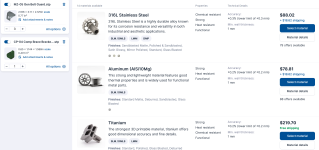

The aluminum was quoting about a third of titanium and titanium was half that of stainless. I'm not sure why, but aluminum didn't seem much more expensive than MJF PA6. How did your stainless come out?
What site did you get those prices from? Craftcloud just did this:
