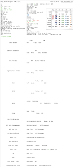

Edward Tufte style update to King Air 350 recurrent limitations and memory items. Planning on making up something similar for the RV-6 panel.
Below are 98 flash cards crammed into 1 card, with an Edward Tufte angle. (longtime fan - have several of his books).
It’s King Air 350 recurrent time here coming up for my side hustle, and I’m trying something new this year in regards to emergency memory items. It’s quite possible I will incorporate this into my RV. In my never ending quest to get more information into fewer characters (something I strangely enjoy), I’ve come up with the following. This method might already exist - I haven’t looked. In a nutshell,
A screen grab of the work in progress….subject to change a hundred times. In my weird brain, I’m finding this more useful than flashcards.
Going to work up something similar for my RV-6.
- In the limitations section up top, numbers are just numbers. '1' means 'one pilot'. That's a limitation. '15' means '15 passengers'. The idea being to get rid of everything except the actual data that needs to be in my head for the oral.
- in the emergency memory items section: the raised row means ON or PRESS or INCREASE and
- the lower row means RETARD or OFF or DECREASE.
- items in green multiply by 1000 (35 means 35,000)
- blue is icing. red is danger.
- an *asterisk before something means AS REQUIRED.
