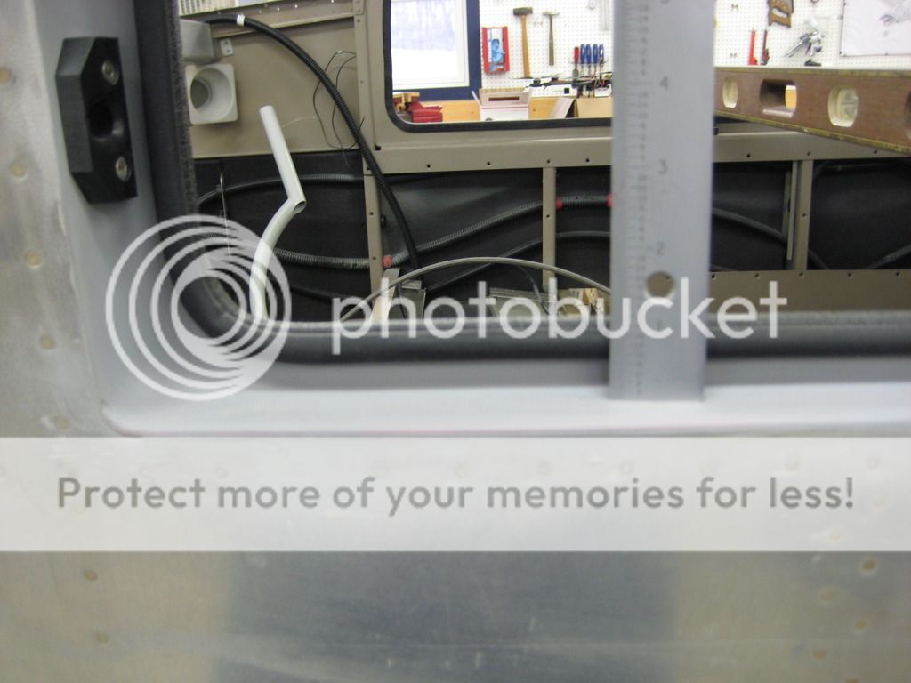

Hi Team,
I've searched but haven't found anything definitive on this. What should be "height" of the lip on the bottom of the cabin top door opening. I've seen some reference to 3/4". Is that the consensus?
It's clear that the sides should be trimmed to 1" and the top should be ~1 1/4".
Can someone share what they've successfully done?
Thanks!
Seal

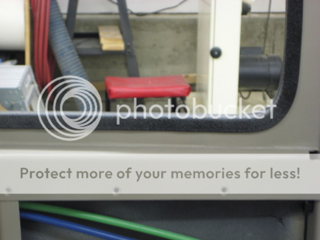

Hey, I just measured my seal and with the seal installed it is about an inch to the top of the seal. Somewhere between 3/4" and 7/8" should work for the flange. If you go shorter and use the planearound latch, the delrin angle will protrude above the seal...
I have a couple of pictures.
IMG_0706_zpsxaz6aczb.jpg.html
http://s1228.photobucket.com/user/rocketman1988/media/IMG_0705_zpspabvaxa6.jpg.html?sort=3&o=1
Just measured mine and it's 3/4"... now I haven't done the doors or anything else so no clue if it will work. If it doesn't work then I guess I'll mix up some more epoxy and milled fibers..
