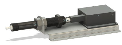

I'm planing to convert to electric trim and as part of that going I'm to make an adapter for the Ray Allen T3-12A. I'm going this route in the event I don't like the electric trim and I can easily swap it back and forth between them without changing the cable. However, what are the threads closest to the cable attach ball (it's smaller than the one with the jam nut)? The major diameter of the threads is about .678" and looks about 16 threads per inch. It seems a size between a 5/8" and 3/4". Are these Metric or British threads?
