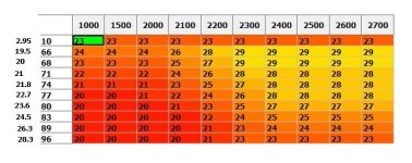

Note the difference in operating philosophy. In theory, we can add ignition advance and pick up power, while accepting higher CHT. Or we can use mild ignition timing, but cut cooling airflow, resulting in the same CHT. I choose the latter because it reduces mechanical stress (lower peak cylinder pressure), and cuts drag.
BTW, I have two onboard maps, one fixed, one advancing, selectable with the flip of a switch. At 22/2450 the advancing schedule (below) triggers at about 28 BTDC...but the airplane doesn't go faster.

Be sure to clock the base timing and install the jumper in order to limit total advance. Or install some sort of controller, Engine Bridge, EI Commander, etc.
If truly LOP, ballpark 8 to 8.5 GPH at ~60%, 28 BTDC will gain 2, maybe 3 knots compared to base 20 BTDC. This "fuel saver" mode is pretty much the entire payoff to a P-mag on a 390, and then only if clocked so total advance is limited. Move to 23 fixed vs 28 advanced, and the spread gets less. As previously noted, advance brings higher peak pressure and higher CHT.

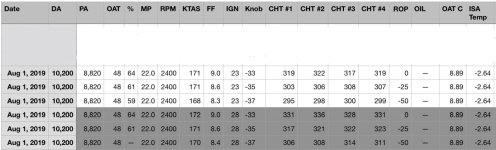

Below, really good data from Marvin McGraw, 23 vs 28 timing with an SDS equipped 390 in a well built RV-14. For clarity, I've cropped out everything but peak EGT, 25 LOP, and 50 LOP. My own tests have not been as detailed as Marvin's (the SDS system allows him to try any number of advance settings on the same flight, while I can only try two), but results have matched.
