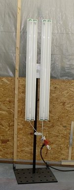

Assemble some glare lights, and keep them positioned so you can really see how the spray is impacting the surface and building under the fan of the gun. Concentrate on looking at the fan contact, not at the surface as a whole. And if you wear glasses, make sure the focal length is correct for the distance, eyeball to surface contact.
The lights are just 4 ft tube lights, rotating on a stand. In the end, even if you don't like painting with them, they make great work lights in a dark hangar.
