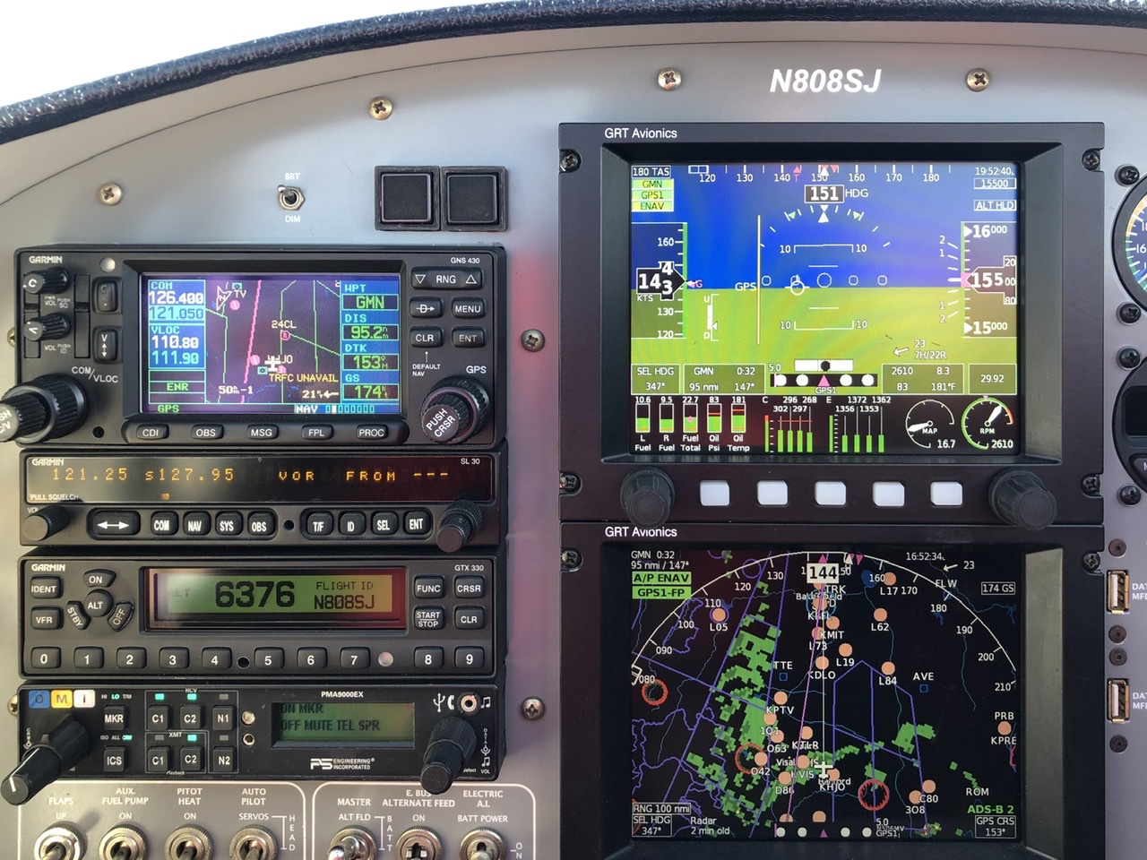

In this first photo, I'm cruising at 15,500 running ROP and high (2600) RPM. 180 KTAS on 8.3 gallons per hour. The plane was loaded with a passenger and lots of luggage. The speeds were helped by cool OAT (~ 0C) and the fact that the plane was in "race mode" with 1 radio antenna removed from the belly, race wingtips that I thought would hurt my heavy, high altitude performance but actually seemed to help based on other testing, and a few other minor details. I was running rich of peak and high RPM to recover horsepower lost my the low manifold pressure of 16.7 inHg.

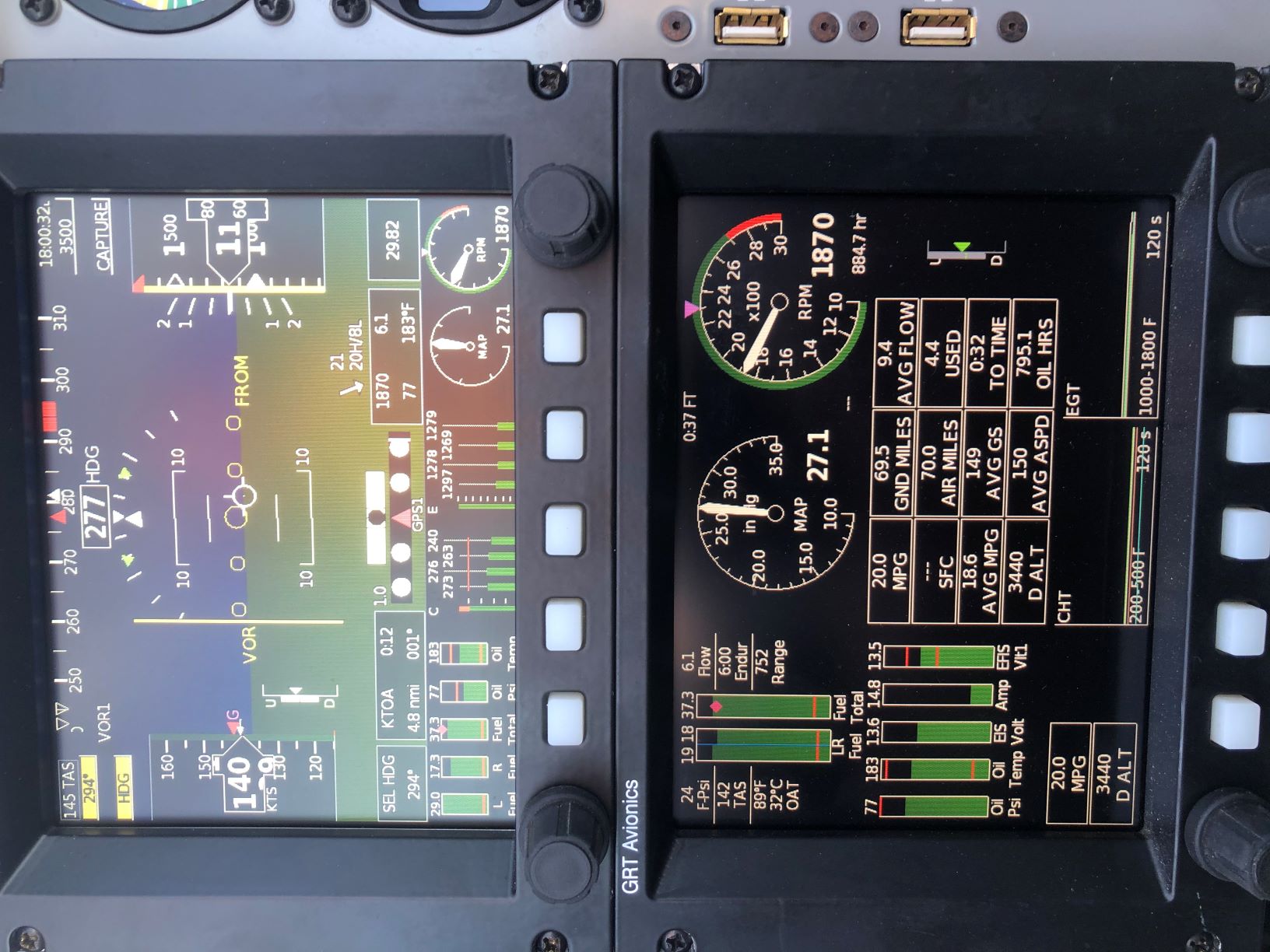

In this second image which I've shared before, I'm loafing around down low at high manifold pressure, very LOP, and very low RPM to make up for my fixed timing with the lean mixture. I usually cruise at low altitude LOP, using mixture and RPM instead of throttle to control the power. The engine runs clean, cool, and reasonably efficient this way. Here I'm at 27.1 inHg, 1870 RPM and 6.1 GPH.
Skylor
p.s. Does anyone know why the second images is rotated horizontally in internet explorer, but displays normally in firefox when viewed on my laptop?
Wow, I don't mind running somewhat over-square, but wow. The Lycoming operating manual has curves of Hp for various combinations of MAP and RPM. The 27" MAP line extends down to about 2400 RPM IIRC.
Dave Anders often runs very low RPM in cruise getting some pretty incredible numbers. Low RPM cuts engine frictional losses quite a bit.
Does anyone have any data on how high MAP/ low RPM affects engine life?
Again, numbers would help understanding. Skylor said 27". Is Dave running high MP, or cruising at altitude, with low MP? Apple and orange.
Likewise, "engine life" is very general. Like ignition timing, one size does not fit all. The long term result may be quite different for cranks with and without pendulum absorbers. Has anyone in the propeller business extended a blade vibration survey to the extreme oversquare regime?
I'm not saying it's bad. I'm saying God is in the details.
Wow you are fast.
Believe it or not, that photo was taken with the gun pod hanging on the right wing. Beginners luck mostly.
Dave is virtually always WOT, controlling power with RPM. Altitude and power setting is decided by mission, weather and O2 use.
By life, I mean, is typical TBO impacted? Nobody is going to do this if it's known by facts that life goes from 2000 to 200 hours. Not looking for speculation here. Any known studies by someone like Lycoming where continuous oversquare operation has been tested?
High MP

The primary issue normally caused by low RPM at high MPs is high peak cylinder pressures. This can cause several issues including high CHTs, detonation, pendulum absorber harmonics and failure, crank and prop harmonics, etc.
The key though is understanding why the high cylinder pressures occur at low RPM and high MP. Under “normal” ROP mixtures in this case, the cylinder combustion event happens too fast resulting in peak pressures occurring while the piston is still near the top of its stroke and before the crankshaft has rotated very far past the top dead center position. In this area, the cylinder volume is still quite small and the piston is still moving rather slowly away from TDC resulting in a slow rate of cylinder volume expansion. BTW, the angle of crankshaft rotation past TDC where peak cylinder pressure occurs is known as theta-PP. Anyway, when the peak combustion event pressure occurs shortly after TDC (or small theta-PP) the pressure tends to get very high which results in high connecting rod and crankshaft forces. This high pressure also compresses the insulating boundary layer of gas that typically exists along the combustion chamber walls resulting in higher heat transfer into the cylinder, cylinder head, and piston thus causing elevated cylinder and oil temperatures .
Now the above issues are not typically a problem with low density mixtures because their slower burn rate results in a larger theta-PP and lower peak pressures. Historically, manifold pressure has been the tool used to gauge charge density and power levels, hence the reason for recommendations of manifold pressure limits at (or below) certain RPM’s.
However, even at high manifold pressures, if the combustion mixture is very lean (i.e well lean of peak), then we have a slow combustion event that behaves similarly to lower manifold pressure settings. In the case that I posted above, I am running more than 100 degrees LOP. The low cylinder head and oil temperatures on a 90 degree day provide good evidence that the peak cylinder pressures were remaining low in this scenario.
Skylor
p.s. Typed from my phone and not proofread....
