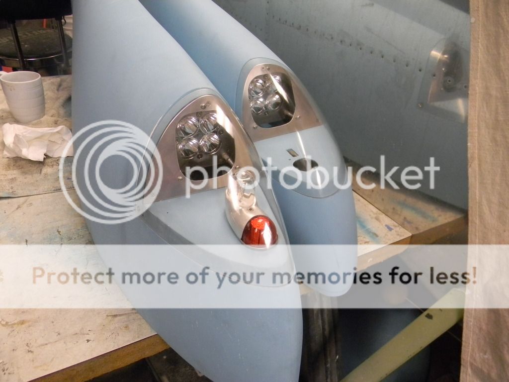

Closing in is my delivery of my QB wings. Prior to shipment I need to decide if I want the stock Wingtip and Lenses or not. That decision depends on my choice of landing lights.
I fly now and plan to fly in the future at night. So the brightness of the landing lights is a concern for me. I also would prefer not to cut into the leading edge of the wing so that seems to limit my choices a bit.
I'm leaning towards the Aveo Ziptips right now. I talked to another Justin who put them on his RV-10 and he said they're extremely bright. He did say he had some issues just because he was the first person to install him. Cost is a bit of a factor too, one place I call quoted me at $2400 for the set... so you deduct the stock tips and lenses and you might be looking at $2K for this solution (not including a rudder light).
The other option is to use AEROLeds in the stock Wingtip's regular place. Looks like you could a pair of Pulsar NS90s & two Sunray Plus's for the landing lights. Plus you can but a complete set including the rudder position/strobe for around $1600.
I'm looking to see if someone has installed these AEROLed Sunray's into the tip and find the light bright. I know that's somewhat subjective but bright to me would mean seeing the runway at about 50 ft up.
So I'm on the fence, if it turns out these AEROLed's are similiar in brightness to the Aveo Ziptips then it really just comes down to the $800 delta and if the neatness and 180 degree recognition of the Ziptips is worth it to me.

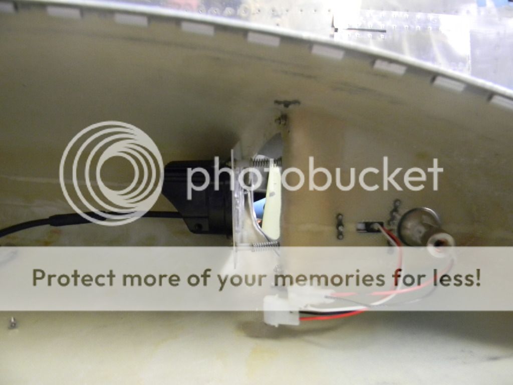

I installed the stock 75watt vans supplied wing tip lights and then installed the Aerosport Baja design landing light in the cowling. I wig wag the wing tip lights until 75 knots and have the cowl light on continuous during landings. With this combination the runway looks like daylight. If you do a search in the rv10 list on landing light you will find some photos of the installation and actual night photos. The nice thing about the cowl light is it is centered on the runway

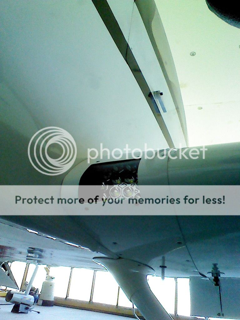

It takes a bit of doing but the Aerosun VX will fit with the ER tanks. You need to do some fiberglass work on the stock wing tips.

Aerosun vx and safeair er tanks
I can confirm that the aerosun vx lights doesn't fit with safeair er tanks. I had to cut the front corners off the er tanks and had it re welded and pressure/leak tested

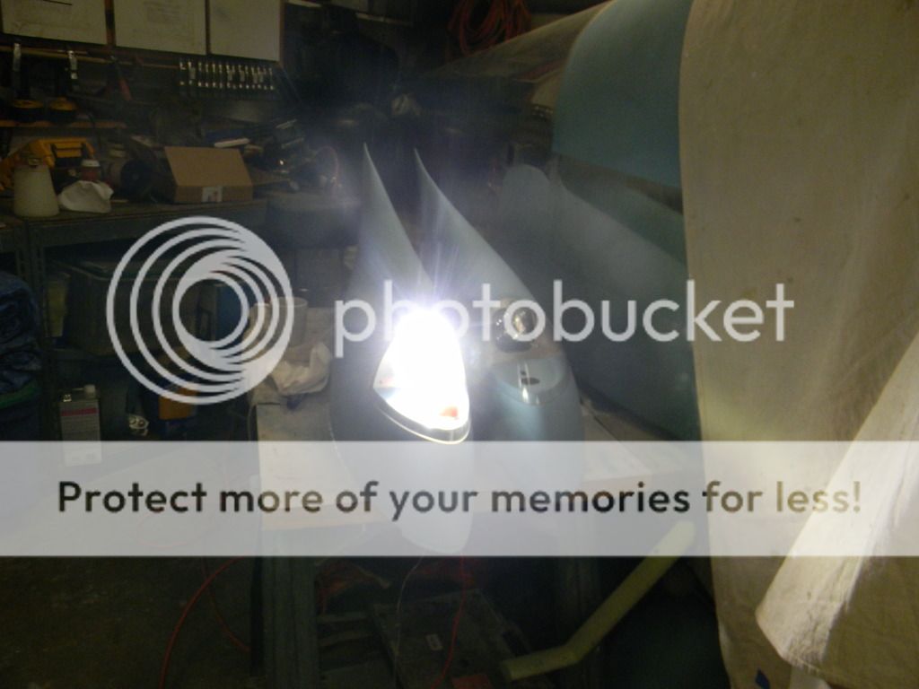

Just fired up mine over the weekend. Baja Squadron Pro 49-0001 (spot beam).
Set my wingtip on a table 10-12? from the hangar door
then stood back maybe 25' to take the photo. The reflection
was too bright to look at directly.

I did the baja designs instal similar to what's in this thread:
http://www.vansairforce.com/community/showthread.php?t=105248&highlight=Baja+designs
And while we haven't flown yet, I've fired them up at night to test the distance and aiming, and WOW!! Pretty awesome. But, I already knew the lights were amazing as I use them on my motorcycle and truck.....
