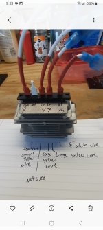

Jesse, Burned wire ends are likely caused by bad connections which make heat. Make sure connections on the new regulator are tight. Each wire terminal should be connected individually so that you can tell how tight it is. If all of the terminals are grouped together in one plastic housing, then the installer can not tell how tight each individual terminal is.
Post the wire size and color of each wire and where it connects to the B&C regulator and I will figure out where to connect them to the John Deere regulator.
It had the plastic housing plug. And the copper wire is 14 gauge. Both of the 14 yellow wires were burnt up. The smaller yellow wire was not.

The two large yellow wires come from the generator and are AC input to the regulator. The small yellow wire connects to the John Deere IGW terminal and enables the regulator. The white wire(s) connect to B+. At least that is the way my plane is wired. Vans made changes over the years.

The John Deere regulator terminals are different than the Ducati. So not plug and play.
I have a ULS that had the Ducati fail at 120 hours. I bought (4) AM101406'S and pre-wired as shown in pic. The wire colors mentioned are as they were attached to the Ducati. When I op's checked them, 1 put out 13.2v so tossed it. Another put out 14.9v so I tossed that one too. The 3rd put out 14v and the 4th 13.8. I installed the 14v and keep the 13.8 on board for a spare. I relocated VR to below passenger side instrument panel and use passenger vent to direct (via a tube) blast air on it. 230 hours now with no issues on a $25 VR.
