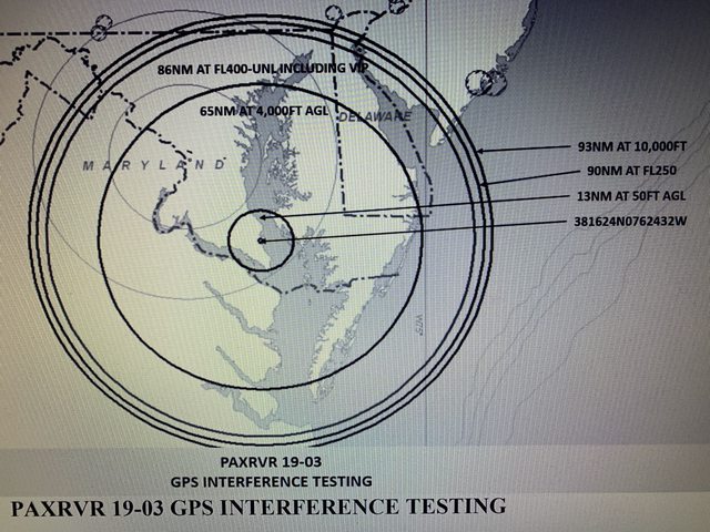

Forgive if this was posted already: They talk about FAA reducing VOR's and more GPS outages from military activity.
https://aopalive.aopa.org/detail/vi...ive-this-week---august-29-2019?autoStart=true
The GPS commentary starts at 0:43. Wiki:

I was flying on an IFR flight plan monday to Las Cruces NM when the airplane symbol on the G1000 MFD changed into a DR (dead reckoning mode). The data for time and distance changed from magenta to yellow. We started navigating via VOR. That lasted about 10 minutes then all data was lost. We used ground based navigation for the rest of our flight. There was a NOTAM out for GPS jamming originating from the White Sands Missile Range. GPS jamming is occurring more regularly with no end in sight.

Well slap my arse and call me Bridget, look what the locals just sent me. How appropriate:
https://www.faasafety.gov/files/notices/2019/Aug/PAXRVR_19-03_GPS_Flight_Advisory.pdf
