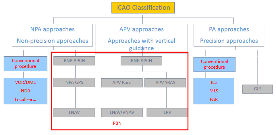

I may be wrong, but I think you mean LNAV, not LPV. LNAV is a non-precision approach - no vertical guidance. LPV is what you get with a WAAS receiver, which does provide precision approaches.
When I was studying this I remember being surprised that LPV was not an PA (Precision Approach) and was considered an APV (Approach with Vertical Guidance). Then I started looking at some ICAO approach classification charts and LPV was listed under both APV and PA but under different Types of approaches......Can we get more confusing please?:D
LPV is still a non-precision approach. LPV and APV are synonymous.
From AIM 1-1-20. Wide Area Augmentation System (WAAS)
b. Instrument Approach Capabilities
1. A new class of approach procedures which provide vertical guidance, but which do not meet the ICAO Annex 10 requirements for precision approaches has been developed to support satellite navigation use for aviation applications worldwide. These new procedures called Approach with Vertical Guidance (APV), are defined in ICAO Annex 6, and include approaches such as the LNAV/VNAV procedures presently being flown with barometric vertical navigation (Baro-VNAV). These approaches provide vertical guidance, but do not meet the more stringent standards of a precision approach. Properly certified WAAS receivers will be able to fly these LNAV/VNAV procedures using a WAAS electronic glide path, which eliminates the errors that can be introduced by using Barometric altimetery.

Correct. So you cannot fly to an alternate using minimums lower than 800/2 if you just have LPV. You can if you have an ILS. This is very straightforward.
I believe the regs state that you cannot "FILE" to that alternate in your example. Once in the air, you can go where ever you think is best, without limitation from the regs, beyond the standard approach minimums. Those limitations are based upon flight conditions and not forecasted or reported conditions. Most LPVs are 200/.5 to 400/1.

Oh my. A lot of confusing misinformation. Review:
1. If you file IFR to Kxyz, then, unless kxyz has an approach you can use, and, +-1 hour of your ETA, the forecast calls for a 2000? ceiling and 3 miles visibility, or better, then you must file an alternate (people call this the 1-2-3 rule).
2. The alternate airport you file to must have a forecast that indicates the weather will be better than 600? ceiling, 2 mile visibility, if it has an ILS and you have ILS equipment; for all other approaches, you need to have 800? - 2 miles. (Military PAR approaches are also 600?-2). Many airports have ?non-standard? alternate minimum wx requirements. You need to check.
3. You must carry enough gas to fly to the destination, then to the alternate, plus 45 min reserve still left.
It?s really #3 that is usually limiting. You may file (and shoot the approach, but not below minimums) to an airport that?s 0-0. But you cannot depart unless you have enough gas to satisfy #3.
To answer someone?s question: Yes, ?LNAV+V? is a Garmin invention, not to be confused with LNAV/VNAV. LNAV +V will show an advisory glide slope designed to keep you at or above LNAV minimum altitudes. But it is an LNAV approach, LNAV minimums apply. Using the glide slope is optional.
