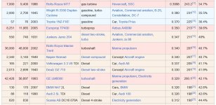

https://en.wikipedia.org/wiki/Junkers_Jumo_205
Jumo 205
6 cylinders, 12 pistons, 2 crankshafts
700hp max power
0.231 kg/kWh at max power
Looking at the attached list of engines by brake specific fuel consumption, it took from the 1930s to 1990 for an automotive diesel to match or beat the fuel consumption of the Jumo engine.
