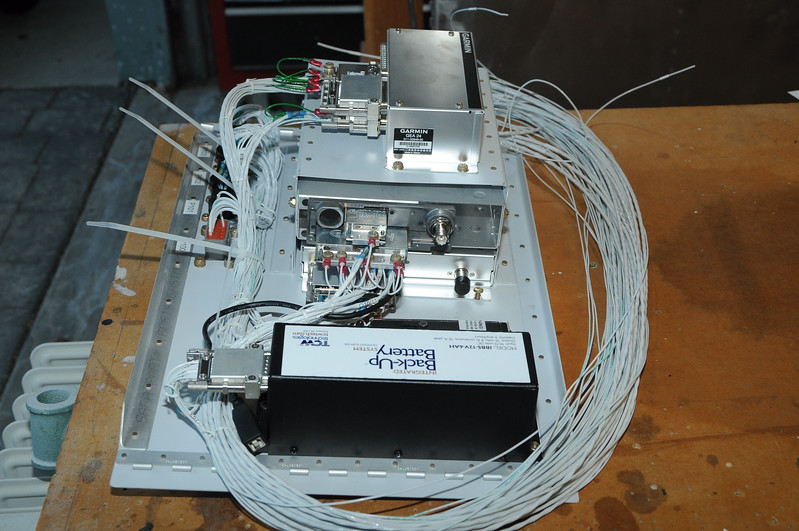

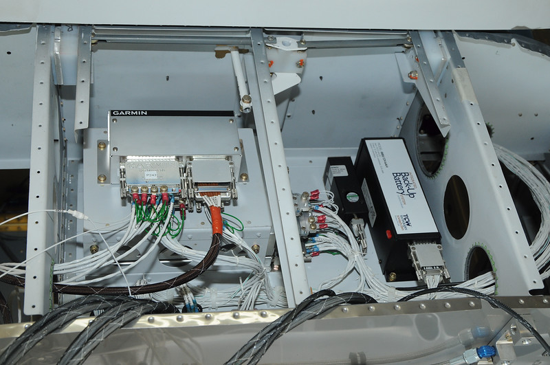

I put 2 access panels in my -7 Tip-Up during construction and after 3 years of flying would absolutely do it again. I have the VP-X, remote transponder, and other avionics equipment just aft of the firewall and it is a bit difficult to get to when the interior is in. he access panels make it SO easy. I made doublers for the forward skin with two rows of rivets around the perimeter and brought them over to Van's. One of the engineers unofficially blessed it so I moved ahead with it.
I smeared a very thin coat of the FlameMaster (makers of ProSeal) access panel sealant before securing the covers. I can't remember the model number of the sealant off the top of my head. Water has never been an issue.
