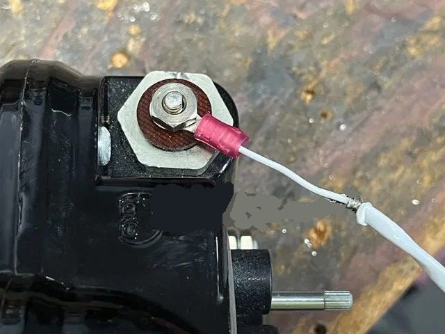

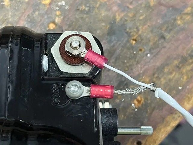

Installations like this...
or like this...
...are, in my opinion, both unairworthy.
This is the minimum, p-lead fully fixated so the wires are not flopping around while hanging on a crimp.
If exposed braid isn't desired, use a solder sleeve pigtail.

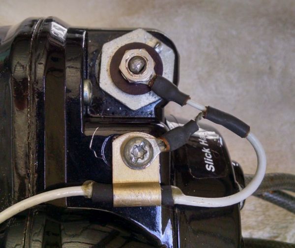

I will be using the mag earth screw and an Adel cushion clamp to support the P-lead as DanH showed above. Such a brilliantly simple idea. Thank you DanH
