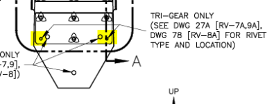

I am building a 7A. I see the bolts for the VS will be through the hinge as well, but I also assume Van's recommends the rivets there for a reason.Depends a bit on what you're building, -7 or -7A. Jump ahead in the plans, and look at DWG 27, 27A; you can see how the VS is going to be installed.
A bolt (AN3-nnA) will do a better job than an AN426AD4-5 rivet...
The issue I see is the need to countersink for a flush rivet on the forward side of the VS rear spar.That might be a fit for a CherryMax pull rivet.
Yes, those rivets hold the hinge bracket to the spar web and doubler. *But* - since you forgot - just locate the holes and drill them up to 3/16" (number #12 drill) and slap a couple of AN3 bolts through the entire assembly when you get to that point in the plans.I am building a 7A. I see the bolts for the VS will be through the hinge as well, but I also assume Van's recommends the rivets there for a reason.
I remember now. There's a thin layer on the forward side. The VS-808PP spar gets countersinked and the thin VS-803PP layer dimpled. That's the OP's issue. It's assembled so there's no way to complete the task.I thought the same thing. The OP must be misunderstanding the drawings. Unless we're both missing what his question is...?
Bingo Larry, you nailed my issue. With it assembled I cannot countersink without knife-edging the thin layer. Sigh... I will reach out to the mothership and see what they say.I remember now. There's a thin layer on the forward side. The VS-808PP spar gets countersinked and the thin VS-803PP layer dimpled. That's the OP's issue. It's assembled so there's no way to complete the task.

It's two pieces -- the spar and the doubler. The doubler needs to be countersunk to accept the dimples in the spar web.I remember now. There's a thin layer on the forward side. The VS-808PP spar gets countersinked and the thin VS-803PP layer dimpled. That's the OP's issue. It's assembled so there's no way to complete the task.

You're saying drill and upsize the VS spar AND the bulkhead in the fuse to accept bolts? That seems extreme, and given that you have to drill through the bracket as well, likely to end up boogering things up.1. Locate and drill the holes, then upsize them to accept an AN3 bolt and install the two bolts (washers & nuts) when he does the final assembly.
You are. See the drawings above.I have a vague recollection that those two holes may be the ones that bolt the VS to the bulkhead... My -7 tailkit said something about them to be drilled final size during assembly. The drawing calling out countersinking on the spar piece specifically said not to countersink them, nor to dimple the corresponding holes in the C-channel.

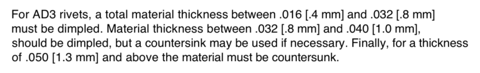

Why would you countersink for an AD4 into a .032 piece of sheet metal when the very next sentence after this screenshot says the minimum thickness for countersinking for AD4 rivets is .050? Drawing 27A specifies the rivet size for this hole, and it's an AD4. That's a little too big to be countersunk for this thickness sheet metal - you won't be getting the full strength of the rivet if you do so.The VS-803PP is .032 in thickness, which is the minimum for countersinking, according to Section 5.5 of the builder’s manual.
In theses two locations I would countersink for an NAS1097AD4-7.
Because the underlying material is much, much thicker.Why would you countersink for an AD4 into a .032 piece of sheet metal when the very next sentence after this screenshot says the minimum thickness for countersinking for AD4 rivets is .050? Drawing 27A specifies the rivet size for this hole, and it's an AD4. That's a little too big to be countersunk for this thickness sheet metal - you won't be getting the full strength of the rivet if you do so.
because the factory head size on a NAS1097AD4 is the same size as a AN426-3 but the stank is the same as a -4Why would you countersink for an AD4 into a .032 piece of sheet metal when the very next sentence after this screenshot says the minimum thickness for countersinking for AD4 rivets is .050? Drawing 27A specifies the rivet size for this hole, and it's an AD4. That's a little too big to be countersunk for this thickness sheet metal - you won't be getting the full strength of the rivet if you do so.
I'm not an aircraft structural engineer, but I am a mechanical engineer. My concern is whether the NAS1097AD rivets have the same material properties as the AN426AD rivets, because I don't know what the design intent was for this particular part of the structure - is it shear, tension, or both?because the factory head size on a NAS1097AD4 is the same size as a AN426-3 but the stank is the same as a -4
NAS1097AD are hardened rivetsI'm not an aircraft structural engineer, but I am a mechanical engineer. My concern is whether the NAS1097AD rivets have the same material properties as the AN426AD rivets, because I don't know what the design intent was for this particular part of the structure - is it shear, tension, or both?
I looked up the specs for both NAS1097 and AN426 on ASSIST to determine whether these two specs have the same material properties. Both of them indicated a chain of obsolete specifications with no real information of use. The chain of links ended up pointing to a spec that one would have to buy from aia-aerospace.org.
Spruce differentiates the AN426 into two categories - AN426 (1100 soft) and AN426AD (2117 hard). The plans call for the "hard" version of this rivet, so do you know if the NAS1097AD rivets have the same material properties as the "hard" AN426AD rivets?
