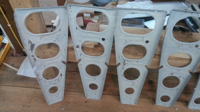

I think I know what happened here, but can anyone tell me and help confirm or deny my suspicion?

Let me guess.....
You didn't acetone or scotchbrite before using a self-etching primer?
Lorne
I used both acetone and an Alumiprep etch prior to the selt etching primer, same basic process I have used on all my prior primed parts.
I've had that cracking/flaking happen when I applied way too much paint (or primer) to the surface.
My guess is moisture. Compressor filter failed/bypassed or moving from air conditioning (cold part) to warm humid outside?

That is my thought. I spent too much time prepping and by the time I was ready to spray (rattle cans), it was dusk and the temperature plummeted and the relative humidity skyrocketed. I feared it would be a problem but I underestimated just how much moisture was in the air.
The only other two differences in my process this time was I wiped the Alumiprep on rather than soaking the ribs, and rinsed with potable water instead of distilled.
I feel your pain, same thing happened to me. Probably the largest batch of parts I primed at one time during the entire build. Like you, evening was coming on, I moved all the parts outside to prime. Didn't realize how much evening moisture was already in the air. Looked great right after I primed, went back later to check, pretty discouraging. Just one of those small setbacks, we don't plan on. Clean em up, reprime and build on! It's all worth it!
Moisture. I had a rudder hung on a clothesline and shot it with green primate right at dusk. Temp dropped, humidity spiked, and all the green cracked and fell off like yours. Next morning I re-prepped and shot the same primate and it was perfect. Then I topped it with Alumi-grip. Perfect. Then the rope broke and it fell in the dirt.

why etch before using a self-etching primer?
Because I believe it does a better job of surface preparation than scuffing alone, and I suspect that the etchant in the self etching primer is perhaps not as aggressive as the Alumiprep?
I suppose I could resolve the question and possibly save myself some time and effort by making test coupons with both processes and doing pull tests.

Happens when you etch the metal, thinking it will help the self etch product grip better.
Years ago this worked, but my experience is that the modern self etch primers do not like pre etched metal. I have found that when you remove the mess, the second try will adhere well. Scotchbrite, clean with acetone or similar, spray to coat.

This has not been my experience. I have primed a number of parts using the Alumiprep etch before SEM self etching rattle can primer, and all others have been just fine.

With my tail section side skins. Cool humid day - I was keeping my Stewart Systems primer inside the warm house, aluminum was nice and cold and it was damp. It looked like someone had sneezed primer on the skins; everything just slowly slid down into a big puddle. :eek: Too embarrassed to make any pictures. Fortunately I could just hose it off and start over when the weather improved.

I get this same problem occasionally, but it is always in very small areas - usually in a corner or radius of a formed part. Never as bad as your photograph shows though.
I wash/scotchbrite with detergent, etch with metal prep, wipe with lacquer thinner, and then prime with SEM rattle can.
I've never figured out why this happens. My fix is to lightly scrub the area with a scotchbrite pad and lacquer thinner and re spray. That always works.
I've run into this problem with the SEM Self-Etching rattle can. I found the consistency of the paint wasn't always great and it was prone to drips out of the nozzle. These drops would dry into flaking sections. I think this was happening more often if it was cooler and if I didn't shake the can enough.
I can make this problem happen easily now just by leaving a little moisture on the surface. If it isn't completely dry, the paint will bubble on contact. I catch this right away now, wipe away the bubble and re-spray. For the sake of disclosure, my current prep scheme is acetone wipe (only as needed), soapy water spray, scotchbrite scrub, clean water spray and wipe off with a lint free shop towel. I do this all in one sitting, painting within a half hour.
