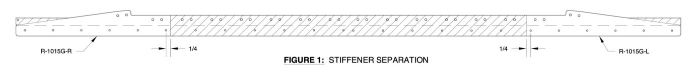

When reading the left side of figures 3 & 4, is there an assumption that the part is sitting flat with the angled portion of the part extending toward you? I can't see any cues on the drawing that makes that certain, but I'm no engineer, I don't know if this is always an assumption or something.
You could also be looking at the part from the flat side with the angle extending away from you, which in this case, would matter since the part isn't symmetrical.
I'm just curious if I'm missing something, whether it is on the drawing, or a convention I'm not aware of.

These drawings are usually based upon the X, Y, Z coordinate system. Different views are usually based upon rotating the part 90 degrees. Normally the view is perpendicular to the part in the basic views. This is a very standard way of showing different aspects of a part.
Think of having the part in your hand and rotating 90 degrees then that is what you would see. If it is a horizontal rotation normally the view is drawn to the side of the part. If it is a vertical rotation the view is normally drawn above or below the part.

For 3 view drawings like this, you can interpret them as if the part was sitting in a bowl (or half sphere). Take the lower left drawing and assume it's on the bottom of the bowl. Slide it up the bowl away from your , look down from the top, and you get the top left projection (90 deg rotation on one axis); slide it from the bottom to the right rim and you get the bottom right projection (90 degree rotation on the other axis).
You can do this experiment with a "real" part to get the feel for how the three projections are done.

The easy way is if the flange was facing away from you, it would be hidden from view by the back of the part. As a hidden line it would be dashed. if the flange was coming out toward you it would be a visible line, and therefore would be solid. In this case it is a solid line, so it is coming out at you.

This is called third angle projection and is the convention in North America, and is the projection shown in the OP's picture of the Vans bracket.

It isometric view is a bit confusing since it doesn't show the short flange with a tapered face. It shows a part that's symmetric, and the other views don't.

What's the purpose of the dashed line running parallel, but very close to the solid line on the right side of the bottom left drawing in figure 3? I get the purpose of the dashes on the flange at the bottom, as they indicate the little kickout, but why do they go all the way up the part?
My guess is just to provide context. It makes it more obvious than if the dashed line where only on the flange, but does it mean something more?

That right end is cut at an angle (beveled) and you're looking at the front view. This front view shows you a solid line being the front edge and the dotted line as being the rear edge of the angle cut.
That right end is cut at angle (beveled) and looking your looking at the front view. You see a solid line being the front edge and the dotted line as being the rear edge of the angle cut.
Holy cow, you're right. I didn't catch that before. It looked to me like it was squared off at the edge of the flange, but now I see the angle goes all the way back. Thanks! Now it makes perfect sense.

As others have said, Vans uses the US drawing convention called 3rd angle projection.
It is not used worldwide. It is common to see 1st angle projection on European documents.
They read 100% mirror image from the above discussion. Watch out for this.

A proper title block will tell you in text and with a small model of a truncated cone (easy to visualize view directionality) what projection type is being used.

The drawing in question from the OP is from a 3D model. The isometrics are true and correct. You can see the off angle flange if you carefully compare the left and right iso views.

the right edge of the part is tapered. Therefore the front edge is visible, but the back edge is hidden and slightly narrower than the front, so it is a dashed (hidden) line going all the way top to bottom.

Looking at the drawing in the upper left, I believe the second horizontal line down would be dashed if the long arm of the angle was pointed away from you.
