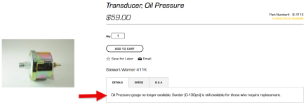

Title is to attract attention but I suspect it is only an indication issue.
Engine @ 1000RPM = ~105 PSI indication.
Engine not running = ~ 42 PSI indication.
The oil pressure transducer (Stewart Warner 411K) was R&R'd with identical results. The wiring has been inspected with no anomalies noted.
I have done some dumpster diving in the airforce forums and my guess is the culprit would be the gauge but would like your input. Another thought - is there a procedure to calibrate/adjust the gauge?
If you also agree that the gauge is most likely the culprit, does anyone have one lying around from an upgrade, as the Mothership no longer supports the gauge?
Thanks in advance!
-Billy D.

I may also add - I tested it in all 3 conditions and these are the results:
  1. Electrical and engine power off: the needle is resting on the pin (0 PSI).
  2. Electrical power on, engine off: the needle indicates ~42 PSI.
  3. Electrical power on, engine on: the needle indicates ~105 PSI @ 1000 RPM.

Good morning, Van's Family!
I completed the suggested troubleshooting and still no luck.
  1. Grounded the transducer using the firewall ground bus and the case of the transducer. Same results (~40 psi indication with the engine off).
  2. Unhooked the transducer wire and ran a new wire to the gauge. Same results (~40 psi indication with the engine off)
    I also went through and checked all of the other wiring to the gauge (power/ground). No issues found.
    I am almost certain it is the gauge, but I am having a difficult time finding one. I may make another post asking if anyone has one they could spare.
