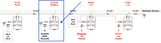

So I have a co-pilot stick enable switch but it isn't working like I expect it to. I ran a wire from the switch (WHT/BLK) to the factory co-pilot stick grounding location (shown below).
The problem is the stick is enabled regardless of the switch position. I tried swapping the BLK ground wire with the WHT/BLK co-pilot stick ground wire. No change. Thoughts????

It is supposed to enable/disable all functions on the co-pilot stick (trim, PTT, flaps, AP disconnect).

Rhis circuit works by providing the ground path for all of the copilot stick functions. The white/black wire should be connected to the common ground wire on the stick / the black wire coming out of the molex at the base of the stick. The connection should be completely isolated from ground. If you have anything connected to ground (the airframe) then the stick will always be enabled.

I connected the white/black wire to the same ground location (same screw) as the factory co-pilot ground wire. I added a photo to the first post showing that location.
I'm not sure what you mean by "the connection should be completely isolated from ground". If I use the factory co-pilot ground wire (which is grounded to the airframe), how can it be isolated from ground. Head spinning....

Unconnected that wire from the screw and splice those two wires togethe. touching the airframe provides a ground and allows the stick to work regardless of switch position.
Ohhhh, just splice the two wires and secure them but no grounding of either. Ok, that makes sense. It actually makes too much sense now that I think about it. At my current pace, I'll have wiring figured out in about 30 years.

This looks like a Stein wiring diagram. I assume they figured it out. ;) Always good to discuss with the panel builder.
