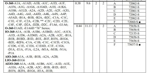

I've tried searching, I've measured, I've studied my prop manual, I've read Hartzell manual 193, I've studied SI 1098 but the bushings I think I've got don't seem to tally with that document.
I have a Hartzell BA prop. 6 x 1/2" bolts. According to the back of the prop, one of the prop bushings must be flush. The others are not flush, as they sit inside the prop hub around the bolts. See below:
My crankshaft flange, however, has six identical bushings (locater for the starter ring gear aside) which means that one must be changed. See below:
My crankshaft flange is 0.38" thick.
The starter ring gear is 0.25" thick.
The bushing outer diameter is 0.75".
So, according to SI 1098, with a dimension A of 0.75" and B of 0.96", I believe all of my current bushings are 72656-S. But none of those apply to the 0.38" thick flange, which I definitely have?
Other than a mild intrigue as to why the bushings I think I have fitted should be for the 0.44" flange rather than my 0.38" flange according to SI1098, I believe that the flush bushing that I require is 72155-S. I.e. dimension B is 0.38" for the flange + 0.25" for the starter ring gear = 0.63" or ~0.65"
Would it be acceptable to trim my current longer bushing down flush with the starter ring gear or must I replace it with the correct, unaltered bushing? I'm sure with a die grinder I could get it nicely flush, with care?
Secondly, because all of my current bushings are identical apart from the "0" bushing that locates on the starter ring gear, which one of the six bushings should be the one to be trimmed / replaced? Again, I'm struggling to find info on whether this propeller needs to be clocked. Some anecdotal reports suggest 2/8 o'clock.
The Hartzell manual says consult the engine manual and my engine is rebuilt / modified and therefore does not conform to any one particular manual. A search of generic Lycoming owners manuals did not reveal any information with respect to prop bushing either.
Can anyone point me to where I can find the answers to the above, please?
