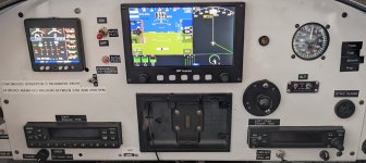

My plane is down for several months and I'm trying to conceptualize a budget upgrade path for my panel. I have bought a GTN 625 for the purpose of enabling IFR practice approaches, but recently ruled out the possibility of adding it to the existing panel due to a rats nest of wiring, and would like to build a clean, reliable panel from scratch. I basically want to build a panel completely on the bench and then transplant it into the plane to avoid having to work with any of the existing wiring. After looking at Dynon/AFS, I think the price is just going to be too high - especially if I want to use the ACM.

Present equipment
My goals for a new panel:
I need a lot of help figuring out if this plan makes sense, figuring out how to block-diagram connectivity, and understanding the wiring diagram that I will have to create.
